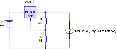

can i not use a power resistor of about 50w, i could go out and buy a 1.5v battery to do this seperately or even a starter but i wanted to try a few things, learn a few things aswell, if its impossible ill admit defeat but i would of thaught there was a way somehow :(
You 'could' use a 50W resistor - although such a resistor would require mounting on a VERY substantial heatsink, and run hot enough to burn you (or make toast).
This of course assumes you're not running it off 4xAA's - which will be unable to supply a fraction of the required power.

I just googled 'glowplug battery', and there are plenty of low cost options - a single Alkaline C cell for example - or for £7.76 (inc. postage) a unit that works off 6V-24V (presumably a switchmode regulator).

Just use a separate 1.5V battery that can deliver the current (such as an alkaline D cell) for the glow plug. Requires just one added part (no more than adding a resistor).
Would that be a problem?
There seem to be two problems here: 1) Appropriate current for a model glow plug; and 2) Getting the voltage regulator to work as you expect.
For the glow plug, you need to limit the current to 1.5 to 2 A, say for O.S. plugs. The voltage in a sense is irrelevant. As pointed out, the internal resistance of your source will limit the current. You can use a resistor to limit the current, just as you do with LED's, a purpose-made glow plug driver, or use a lower-voltage battery. It is extremely common to use a NiCd (1.2 V nominal) to power a glow plug. Batteries with other chemistries can also be used, but be sure they are not damaged by that supplying that level of current.

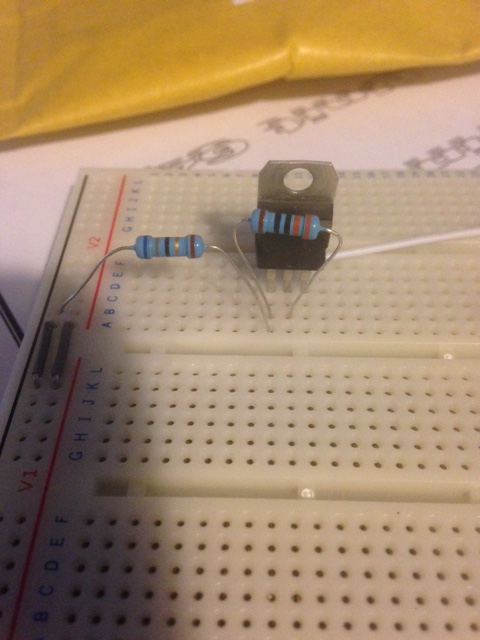

hello,
i need to start looking at this when im at home, the resistance muct be 15 ohms thinking about it, im honestly not sure, i break up today :D
i will get home and check all this and try to let you all know

If you want to stay with the 6V power source, then the better way to do it is by pulse width modulation. Ideally a buck converter with an inductor but, since the load is fundamentally a resistive heater, it can be just a simple 555 driving a mosfet.
If your input is 6V and you want an effective 1.5V, you could just run the 555 at 25%. However, since the 'heat' in the load is a function of the square of the current, 25% will be way too high. Probably something around 5-10%.
The current pulses drawn from the 6V source will be 4 times what they would be at 1.5V, but of low duty cycle. You may need a good low ESR cap in parallel with the voltage source.
The big advantage of this method is that nearly all of the input power ends up in the load, instead of only 25%.
Why not use a ni-cad as John suggested? Or several in parallel? The glow plug only needs power for a few seconds in normal use, so the battery could power it for that time, and be re-charged at a moderate current from your 6v supply for the rest of the time. With a 6v supply you would only need a resistor in series with it to get adequate current regulation - it's what the makers of cheap battery chargers used to do, apparently. If you used NiMh cells you wouldn't even have a significant problem with cell memory.
You are forgetting that your battery ESR must be at least load/10 to maintain voltage.
For in other words be capable of proving the current you need.
I suggest several D cells or a LiPo battery. with a current limit R= of 0.1Ω to divide voltage in half from 3.6V
