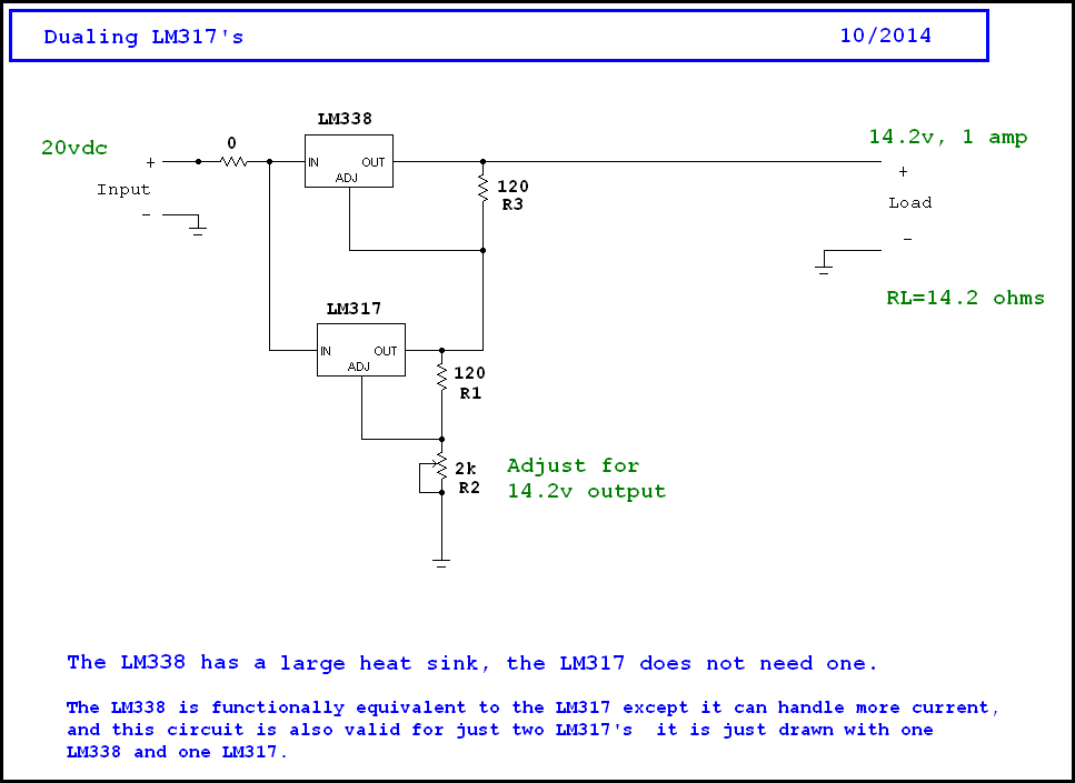

Hello again,
First, thanks to the other members for participating in the first circuit challenge with the LM317. It is interesting to hear others ideas about these circuit problems and how they might be dealt with.
Here again we have an LM317, except this time there are two of them in the same circuit and no, they are not wired in parallel for higher current.
There is a serious flaw in this circuit, doing strictly by the data sheet specs. But this circuit also begs the question, "Why two LM317's in the same circuit if they are not in parallel, what could possibly be the advantage of doing this?"
Assuming we could 'fix' that flaw, there are also a couple drawbacks. One is that the lower LM317 can only be adjusted down to a min of 1.25v and with the upper at a min of 1.25v that means the minimum output voltage is 2.5v not 1.25v like with a single LM317. This may or may not be significant for your personal use, but worth noting. For now however we will assume that we want a min output of something above 2.5v, and for this particular problem the output is adjusted to 14.200 volts.
So can you find the fatal flaw, and if fixed, what would be the reason for using two LM317's instead of just one when they are not intended to be wired in parallel for more output current ?
If you would like to provide your results then please go ahead and just post them. If someone else agrees then they can just post that or more if they like.
Thanks for your interest :)

Geeze, i have to apologize here as i posted the wrong circuit for the question about "why" there would be two of them as that circuit has an op amp too. Too much in a hurry to get it posted but i am glad i came back to double check it.:)
It is however the circuit for the question about "the fatal flaw". So the question here is what is the fatal flaw and not why the two are in the circuit. I'll try to draw that one up tonight or tomorrow.
The second question, "why two LM317's" is still valid for that circuit, but only when the output is at least about 5v or so, and better at 10v and above. So if you would still like to tackle it as is, that's fine too, but only the advantage of two occurs only when the output voltage is about 5v or higher.
The one problem I see is that it has poor ripple rejection as any ripple at the output shows up on the sense voltage. Haven't seen an advantage yet.:wideyed:
My take on it is that the circuit with two LM317s is less sensitive to the voltage drop problem of the circuit with the single LM317.
The flaw in the circuit is that there is no allowance for the reference current for the upper regulator or the output current of the lower regulator. The voltage across both 120 Ω resistors should be the same, so the currents through them should be the same. At the point where the two resistors meet, the current should be the same in each, so all the current through one should go though the other. That means there is nowhere for the two regulator currents to go. The lower 120 Ω resistor should be decreased (and the potentiometer changed or adjusted) so that the output current of the lower regulator, plus the reference current of the upper regulator, and the remaining 120 Ω resistor current, can all go though the lower resistor.
Alternatively, a load resistor can be added from the output of the lower regulator to ground.
The LM317 has a minimum load current requirement of anything up to 12 mA (https://www.fairchildsemi.com/datasheets/LM/LM317.pdf) and a reference current of 100 μA, so worst case is that 12.1 mA more current must be guaranteed in the lower resistor than the upper one.
If the upper regulator has an output range of 1.2 - 1.3 V, so to get 12 mA at 1.2 V the upper resistor should be less than 100 Ω. If 1% resistors are used, that can be 99 Ω ±1. The worst case current is 1.3 / 98 = 13.26 mA, so adding to that the 100 μA and the 12 mA, we get 25.36 mA, and to sink that at 1.2 V, we need 47.3 Ω, and again the resistor tolerance should be applied to that.

FATAL FLAW PROBLEM
The "fatal flaw" was that the top regulator sources current into the bottom regulator, so the bottom regulator must be made able to handle the top current plus it's own current, which as Diver said, is about twice the normal current. So with this idea in mind, the bottom regulators R1 should be 60 ohms or add another resistor in parallel to the whole bottom regulator.

It appears that the lower '317, which sources current from the 20V input, can not provide a proper current sink for the top regulator. The top regulator '338 requires a current sink for proper operation, which the lower one can't provide. That would make the '317 completely useless, and I'd expect better results by removing the '317 all together.
Also: You should put some caps in there for stability. 0.1uF on the inside, 10-20uF on the out.

That was very observant of you to see that flaw. And yes, we just wanted to get better temperature stability and also better immunity to that pesky resistance Rs, which now looks smaller thanks to the second LM317.
