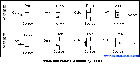

Nor does it look exactly like any of these:

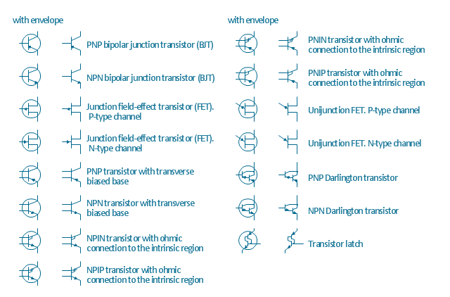

Nor these:
Nor these:

the problem is, it's not marked for polarity... it's neither N-channel, or P-channel... it's either a printing error, or it's something that doesn't exist. the dot showing the connection between the source and bulk is actually fairly commonly shown in print.

Which is fair enough, but as I'd never seen half of the variations of mosfet symbols (enhanced bulk ujt etc.), I thought it worth asking just in case it was some obscure, but clearly defined animal.
