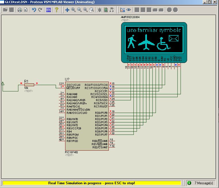

Unicorn GLCD demo.
thanks of bryan and Pommie for reply
thanks Pommie, but i don't need to convert one or two logo.
i need urgent a software for convert logo.
can you give me your software.

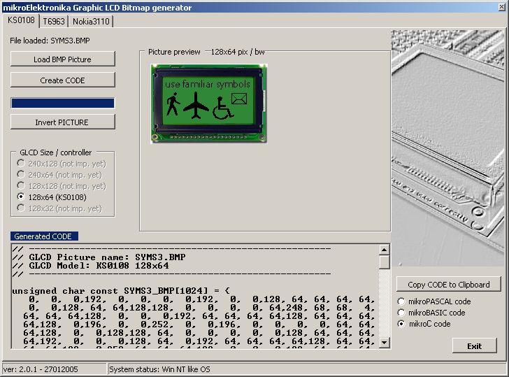

I sometimes use GLCD Generator from Mikro.
mikroC - Advanced C compiler for PIC microcontrollers
If you install the demo it comes with a nice GLCD image converter. You can use it for free. Its a nice tool. Converts BMP to C, BASIC, or PASCAL
When you install the above find this folder:
"C:\Program Files\Mikroelektronika\mikroC\tools\Graphic LCD editor"
and run "glcd_editor.exe" and your set.
You can always create a shortcut to it on your desktop so you can use it when ever you want.
It even has a invert button!
Ill post a screen shot.
I think these converters will work as long as the width is a multiple of 8.
hi Jason
thanks for your help
have you any example program that it use of Mikroc GLCD code generator for
using with GLCD.c and logo function in this Thread.
how you use of this code in logo function the mikroc generate this code for me

i assume you are using Pommies code if so just add the width and height and use:
PutLogo command
this is his PutLogo
void PutLogo(static char rom *logo){
unsigned char w,h,bitcount,Byte;
	w=*logo++;
	h=*logo++;
	bitcount=0;
	do{
		for(i=0;i<w;i++){
			if(bitcount==0){
				bitcount=8;
				Byte=*logo++;
			if(Byte&1) plot(XPos,YPos);
			XPos++;
			Byte/=2;
			bitcount--;
		YPos++;
		XPos-=w;
	}while(--h);
as you can see it takes the first 2 bytes in the array as the Width and Height:
	w=*logo++;
	h=*logo++;
Width first Height second. Then you call it like:
	SetPos(0,0);
	PutLogo((rom char*)SYMS3_BMP);
so the new array should look like:

dear jason, i use of mikroc glcd code generator and i use of your suggestions but the MPLAB c18 have error with this change.
my code is thus:

i change that and haven't any error but it don't display my pic on
GLCD in proteus, also i change the "Inverse picture" in glcd code generator but
it show mixed picture
in attachment i put my files includes(C sourec and proteus)
can you revision it
thanks.

based on proteus i made this header for you :
