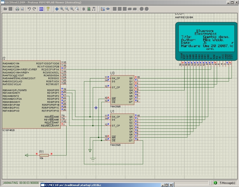

trying hard to get this working heh:
glcd-jpg.35752
then i might use parallel to serial shifters to read data from glcd using resistors.
