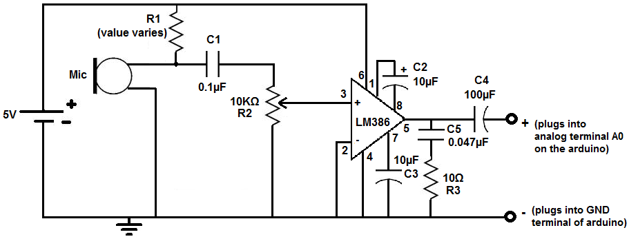

I found this from the internet, do you think this circuit below would work? -

Well you said in your original post your purpose was to understand opamps?, the LM386 ISN'T an opamp, it's an audio power amplifer,often misused on the Internet by people with no clue whatsoever about electronics.
There's a 'sticky' on these forums, which will do you more good than an LM386 circuit, and also includes a 'proper' electret mike preamp.
Yes. There are several application circuits in the LM386 datasheet, and all of them will work as shown - IF - you add strong power supply decoupling. All opamps require power supply decoupling, but as above, the 386 is not a normal opamp and will break into oscillation without it. Add a 0.1 uF ceramic capacitor and 10 uF to 100 uF electrolytic capacitor in parallel across the power pins. they should be as close as possible with the shortest possible leads.
The 386 was designed from the ground up to be a speaker driver. It will work as a microphone preamp (there are many modules available on ebay), but not well. The output will have much more noise than if you used an opamp designed for audio applications. The LM358 also is not a good part to use for audio. The output has much more crossover distortion than an "audio opamp", and the part does not have enough gain-bandwidth for decent fidelity.

He made the LM386 power amplifier circuit and said there was a lot of noise.
But he did not describe the noise. Hum? Hiss? Acoustical feedback howling? All of these noises?
Long wires on the input of any amplifier are antennas that pickup mains hum. Shielded audio cables are used to prevent the hum.
The resistor that powers the microphone must not be connected directly to the positive power supply because the supply might have some hum on it. An RC filter must be used to decouple the power to the mic.
The LM386 is cheap and works best with low gain and fed from a low noise preamp. With the high gain produced by the capacitor between pin 1 and pin 8 then it amplifies its own hiss.
Any sound system produces acoustical feedback howling if the microphone can hear the speaker. Record the mic sound and play it back with the mic turned off.

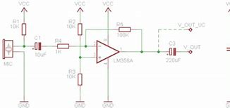

Its possible to build a speaker amp from a lm358, but its not a good idea, its much better to use an Lm380.
If you are interested in how you'd use the '358 heres some info:
The second to last schematic is the closest to the Lm380 circuit, but still far inferior performance wise.
