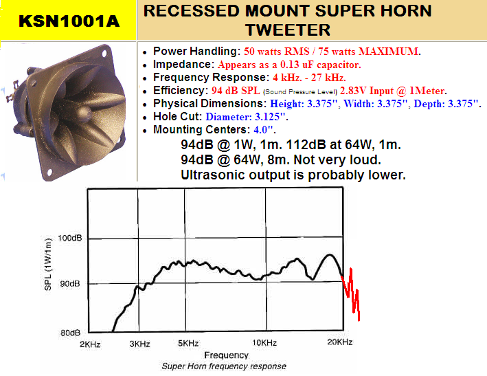

May I know whether this project is really works or not? Since I am currently doing this project too, is there any tweeter or transducer that can play an ultrasonic sound?
Many articles in Google say an ultrasonic pest repellent does not work.
It might scare away some cats.
The old piezo tweeter used on guitar speakers has an erratic frequency response that drops above 18kHz but still has some output at its rated 27kHz.
