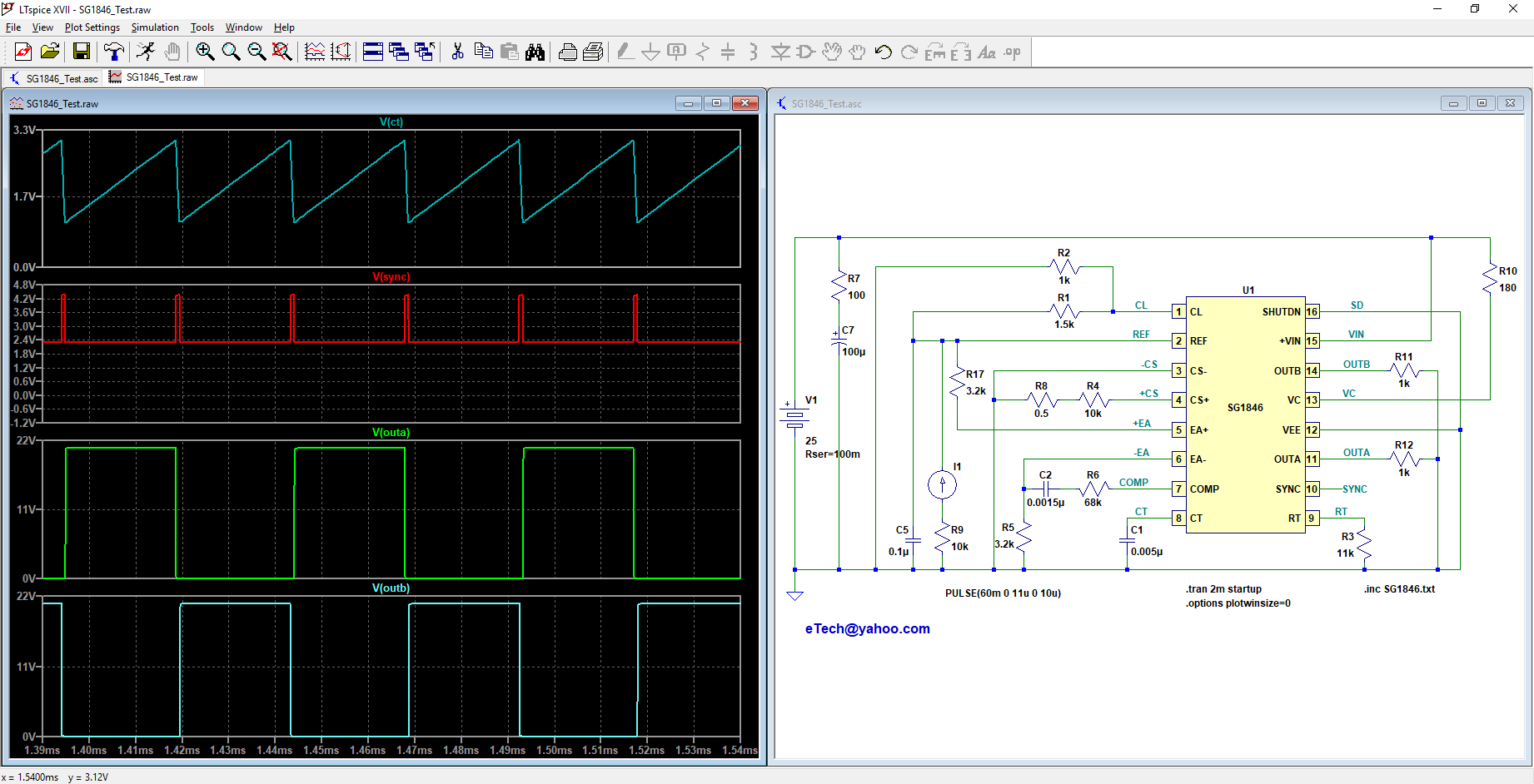

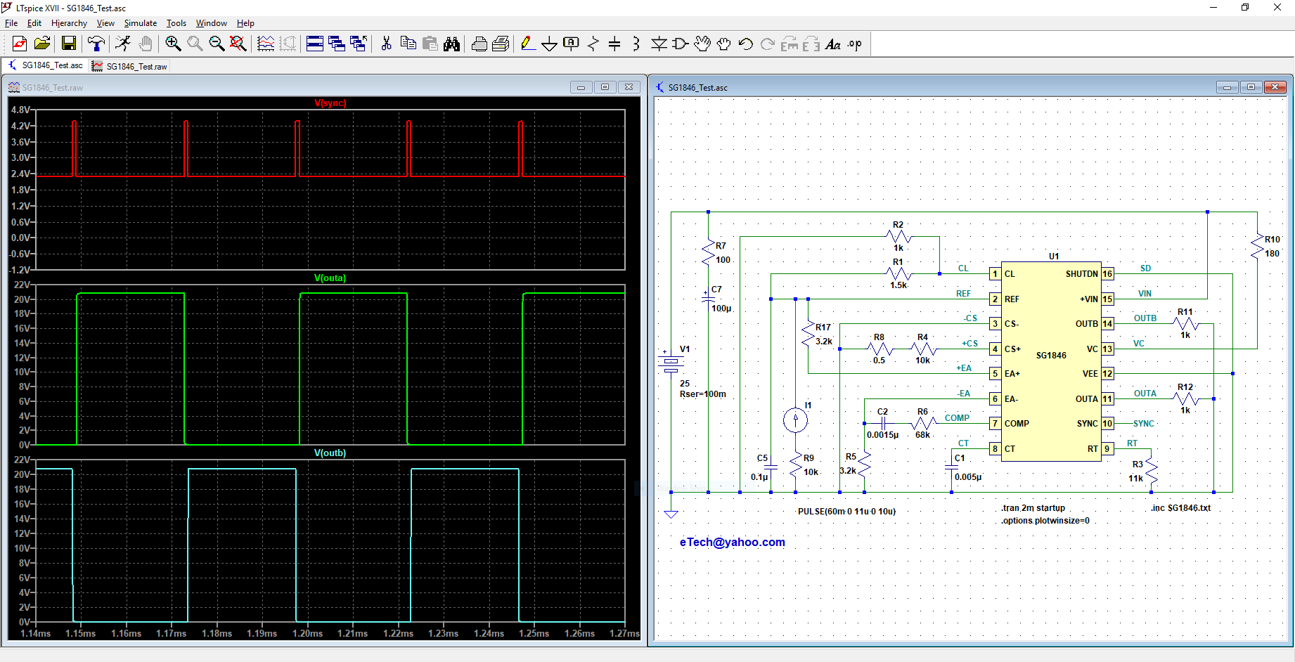

Here is your test circuit using my own LTspice SG1846 model (same as UC1846).
That looks about right, it's operating at 20kHz too, which is exactly what it should be! What does the Ct waveform look like? It should be a sawtooth if I remember correctly (I'm not on my work computer to double check). So what did you do to get this component?
Yup...I've attached an image that includes CT.
