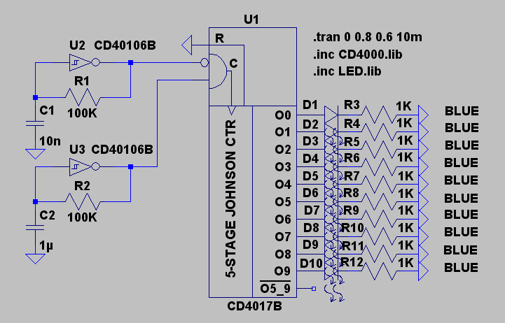

Hi all interested in the circuit,
I've played a little with the circuit for more LEDs. Using the CARRY output of the preceeding stage the next counter will count in logical sequence: BACKWARDS! :confused:
Using the same high clock signal for all stages the count inhibit inputs must have different frequencies. Otherwise the same light pattern applies to every stage. The frequencies used are: 850Hz for main clock, 180Hz for the first count inhibit input and 126Hz for the second count inhibit. (126Hz due to standard value parts used).
The same main clock signal takes care of equal on time for the LEDs. With 20 LEDs the circuit already looks pretty confusing.
Trevors, I guess this circuit is just right for your application. The twinkling is very short though, but the effect will be the same as looking at water waves reflecting the sun.
Another good application idea: Carve a wooden diamond and use the LEDs on it. Your wife will love you for the hugest diamond in the world.
Here is a screenshot of 20 LEDs.

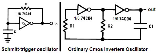

Hi Hans,
Instead of three 555 oscillators you could use 3 inverters from a 74C14 Cmos Schmitt-trigger hex inverter IC.
The output transistors of the CD4017 will overheat without current-limiting resistors (or just a common one) with your very high 12V supply. A 9V supply is safer and the LEDs will be almost as bright.
For 25mA output I would use 74HC4017 ICs with a common current-limiting resistor and a 6V supply. They can be clocked with a 74C14 bunch of oscillators.

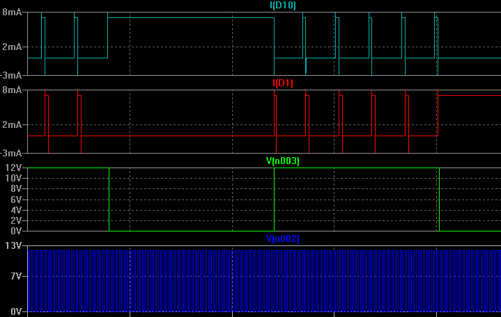

Hi Hans,
It doesn't matter how much your simulator costs if your concept is
wrong. When the counters are counting the leds will be charlieplexed
and they will still light, not as bright but they will light.
I think you gonna have to make a (few) minor modification(s) to your
design. :D

Hi on1aag,
the longer I look on the schematic the lesss charlieplexing I find. :confused: The LEDs will twinkle at full brightness depending on the current. As audioguru already pointed out either the LEDs or the counter will give up sooner or later with a supply voltage of 12V and no current limiting resistors. :D
Especially for you here is the difference between multiplexing and charlieplexing. Neither one applies to my suggested circuit. :)
For more info about charlieplexing visit maxim-ic.com.
Best regards
Hans

Hi hans,
You can make an astable from a single Schmitt-trigger inverter (6 in a package) or from two ordinary inverters.

audioguru said:
Hi hans,
I've made bad experience at lower frequencies. (below 1KHz). For myself I think the choice of a timer circuit is best.
That's probably because you used TTL, not CMOS and used to small resistor and too large capacitor values.
