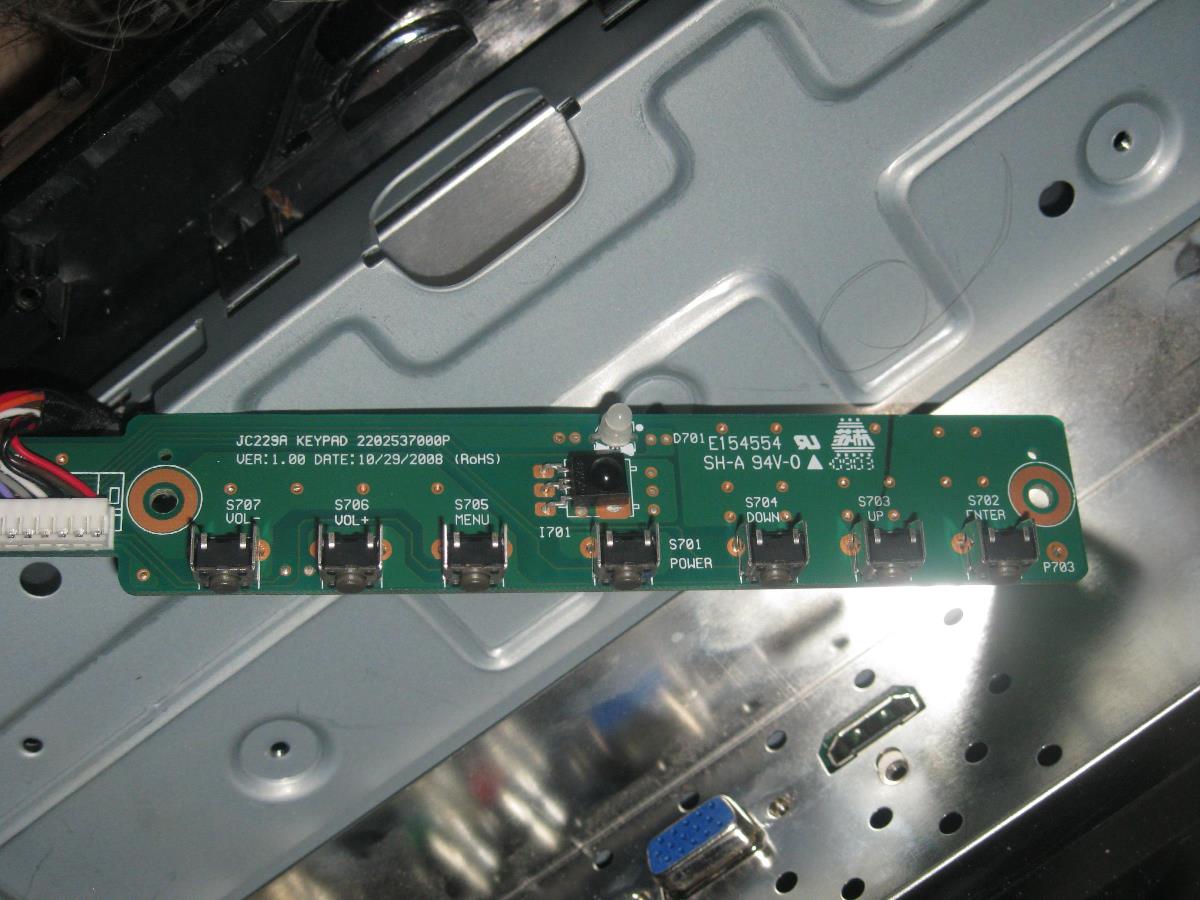

Hi again,
I have included a picture of the switches and board they are mounted on.
As you can see, these are small tac switches but they are independent and are not made by the manufacturer of the tv.
Yes they are cheap ones, but they usually dont go bad especially since i've hardly used them in the whole life of the set.
The way it looks like they work is when you press one, it grounds it's secondary terminal. The primary terminal is always grounded on every switch, so it makes a contact between it's other terminal and ground and that must tell the uC that the switch was closed. The connector and wires bring the signals to the main board, and the cable run is rather long being at least 12 inches.
As you can see the volume switches are on the left side of the board, and the "Enter" switch is on the far right. That made it seem strange that one switch so far away from the other could cause a problem with the other, but then i found out that when you press the channel switch (up or down) THAT causes the ENTER function to execute, so that means that it's not the enter function it's the channel function that is being executed, and that's right next to the volume switches. So all along it looked like the "Enter" function was being executed (by cross talk between the volume switches and the Enter switch) but now i see it looks like some sort of cross talk between the volume switches and the channel switches. But either volume switch can cause the problem.
And normal operation by pressing either channel switch on purpose always causes it to go to TV channel 9 when it is originally on HDMI input.
This makes it hard for me to believe that it could be a dirty switch. These kinds of switches are normally open type, and you really have to press one to get a contact. It's hard to believe that one could close all by itself, unless it was damaged, and then it might take less force to close it.
I suppose i could solder wires on to one of the volume switches and see if connecting the wires together causes the same problem. If there is no physical movement involved on the circuit board then i would seriously doubt that it could be a switch problem.
It was hard to trace out the circuit path because that connector was in the way of seeing the board properly, i guess i should have gotten out the ohm meter, but i really had hoped to see the paths and how close they were to each other.

Hi Mr Al
Some things can not be logically understood. It does not help using a Multimeter for testing good or bad tac's....
Your meter will not guide you.
It does not matter if the tac's have not been used. Trust me on this. They need cleaning or replacement if not available...and lot's of patience if you decide to clean them.....please just try my advise anyway no matter how crazy and illogical it sounds...
All it will cost you is a little can of switch cleaner. And patience.

You're rather missing the point :D they go bad (contacts get dirty) exactly because they have never been used.
They work by switching different value resistors to ground, so if the contacts are dirty (and so too high resistance when pressed) then you get the wrong value resistance presented, so the micro thinks you've pressed a different button. It's a VERY common problem.

Don't you have WD40?, I've been using that in preference to switch-cleaner for decades now, it's far better at cleaning switches and controls.

GP cleaners sometimes are to harsh and can melt some plastics; use WD40 like Nigel said. He suggested it to me sometime ago when I had tuner problems on my guitar amp. Works well.
tvtech:
Unless someone used some precious metals on the contacts, you really need to pass about 1-10 mA through them to "clean" the contacts. Unfortunately, that's the job of the designer, not you. I designed something for a research setting and had to use mercuty wetted relays. The price has gone up considerably. https://www.newark.com/coto-technol...pst-no-5vdc-2a-thd/dp/87F145?MER=BN-PG-87F145 One of the ranges was 1uA full scale.

LOL..this is funny :). I suggested cleaning the switches to start with....and then I am conveniently ignored..

Step 1. Disconnect the Tac's switching pins with a solder sucker...all of them one Tac at a time. So now, as far as your TV is concerned...it has no tac switches.
Step 2. Turn the TV on. See if nothing crazy is happening...like if you are maybe on Video and it stays there....nothing else.
Step 3. Reconnect one Tac at a time....until the problem comes back...and you will of nailed the one screwing up everything.
If you want your TV to work tonight, you would or should maybe follow this simple advise from a simple tvtech...I deal with this stuff daily....
