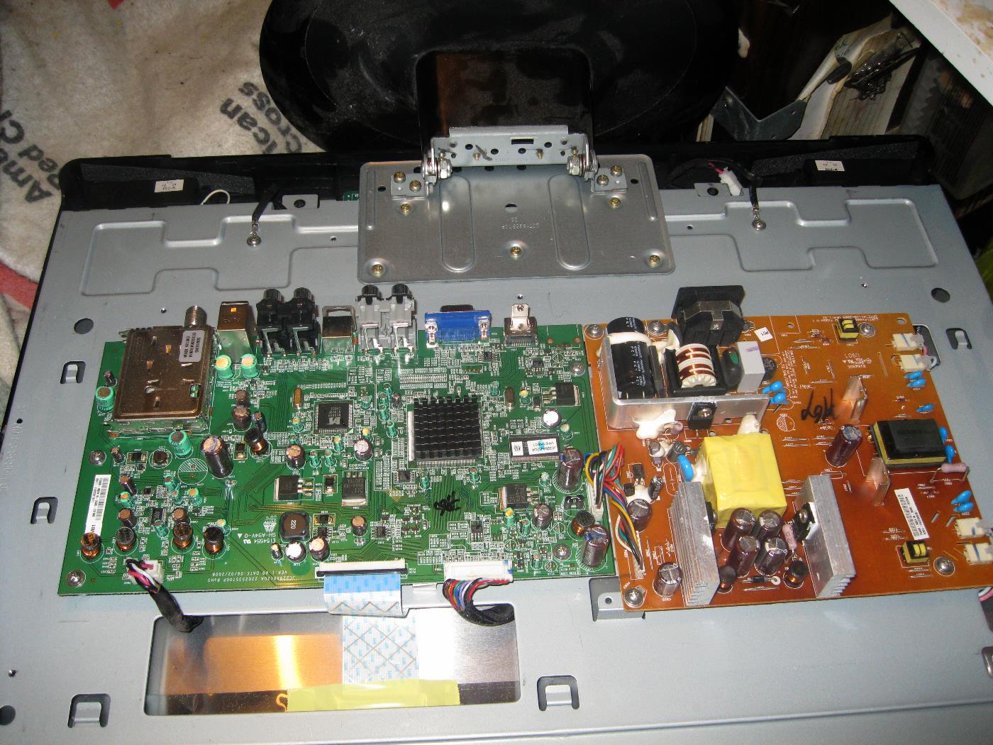

Ok i managed to get it apart, not as easy as it sounds as there were many screws and other stuff to remove in order to get to the power supply. Here are some pics, and it looks pretty clear that three out of the four electrolytics in the pics are bulging at the top. I also included a shot of the whole circuit board. So it definitely looks like some caps are bad, in the low voltage section (16v ratings on all four caps). I doubt i have any that small though laying around.
BTW how long should we wait before working on the circuit board, for the voltages to die down?
Also, what would be the max voltage for the light tube driver, like 300v or something like that or a little lower?
Make sure they are discharged by connecting a resistor across them, or more likely a screwdriver :D
The input to the inverter is low voltage, often 24V or so - the output though is in the thousands, and not something you ever need to measure.

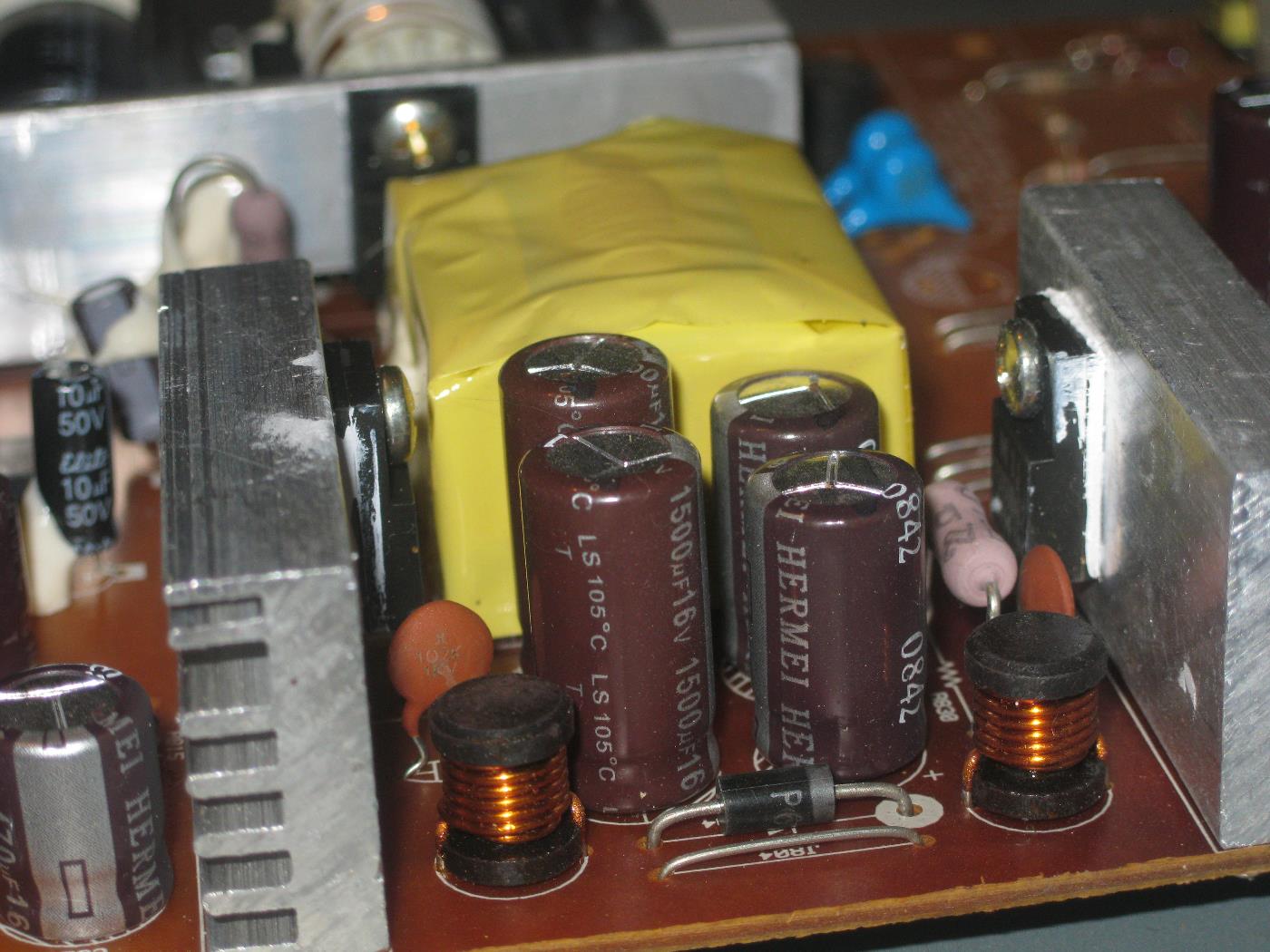

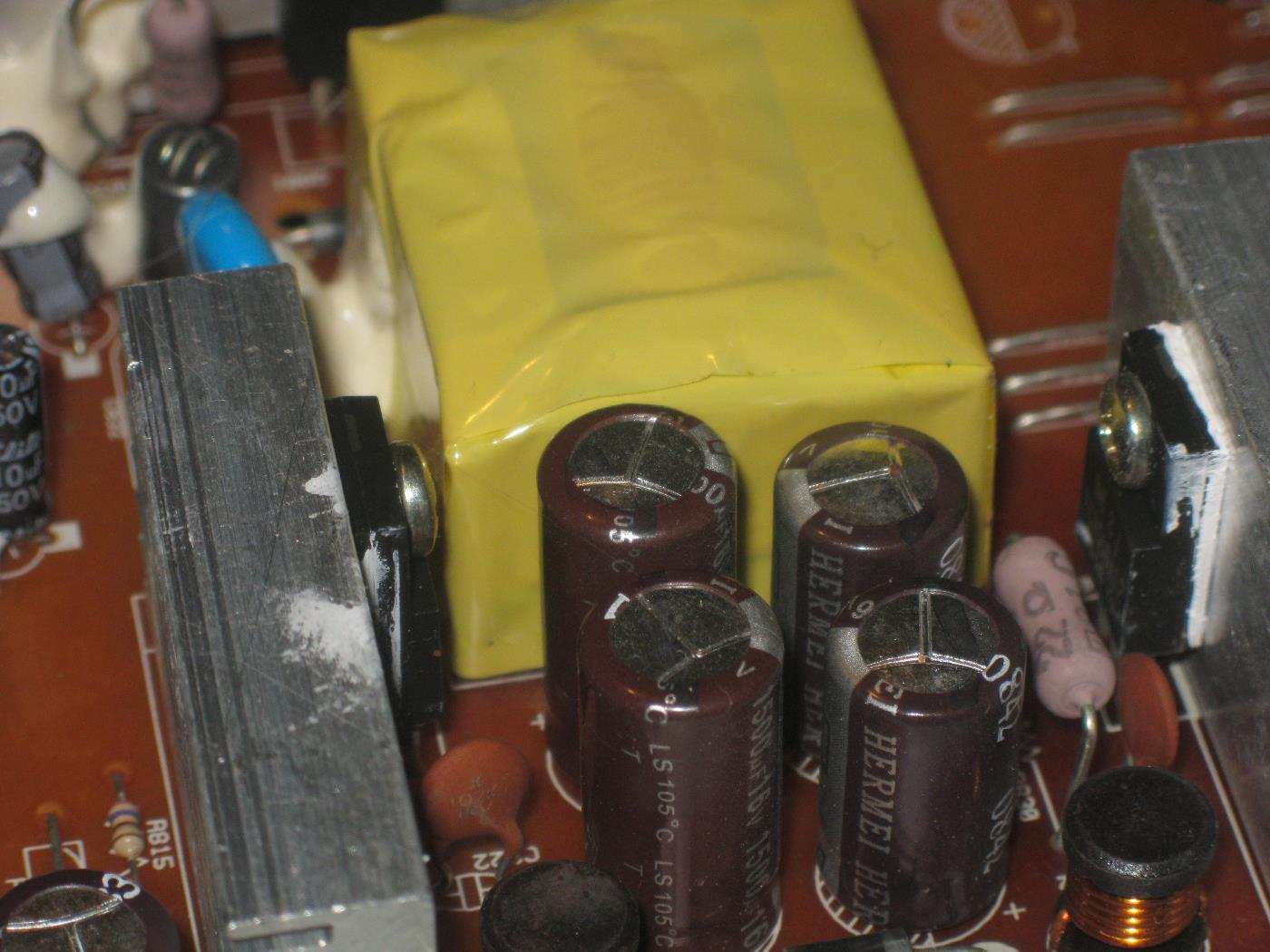

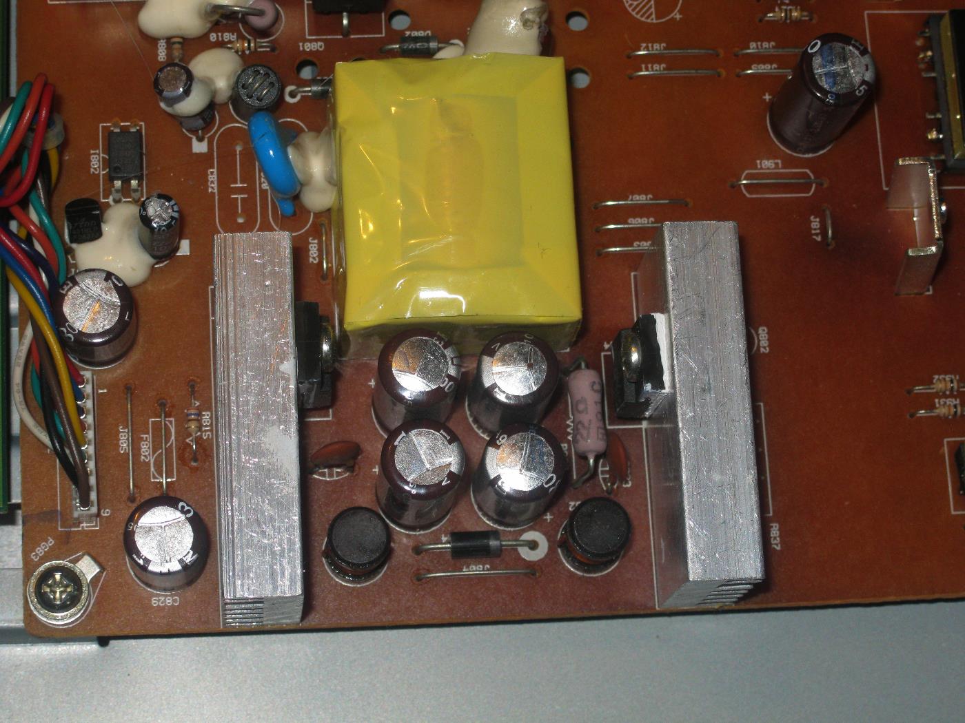

So i got two of the four caps replaced, and fired up the set, and guess what, it turned on immediately. Before that it would not turn on again at all yesterday even after 10 to 20 tries, and now it turned on with the first try, so i figure that was the whole problem as many here had suspected. I now only have to get one more cap to finish the repair.
Thanks to everyone here who added ideas and suggestions, especially you Nigel.

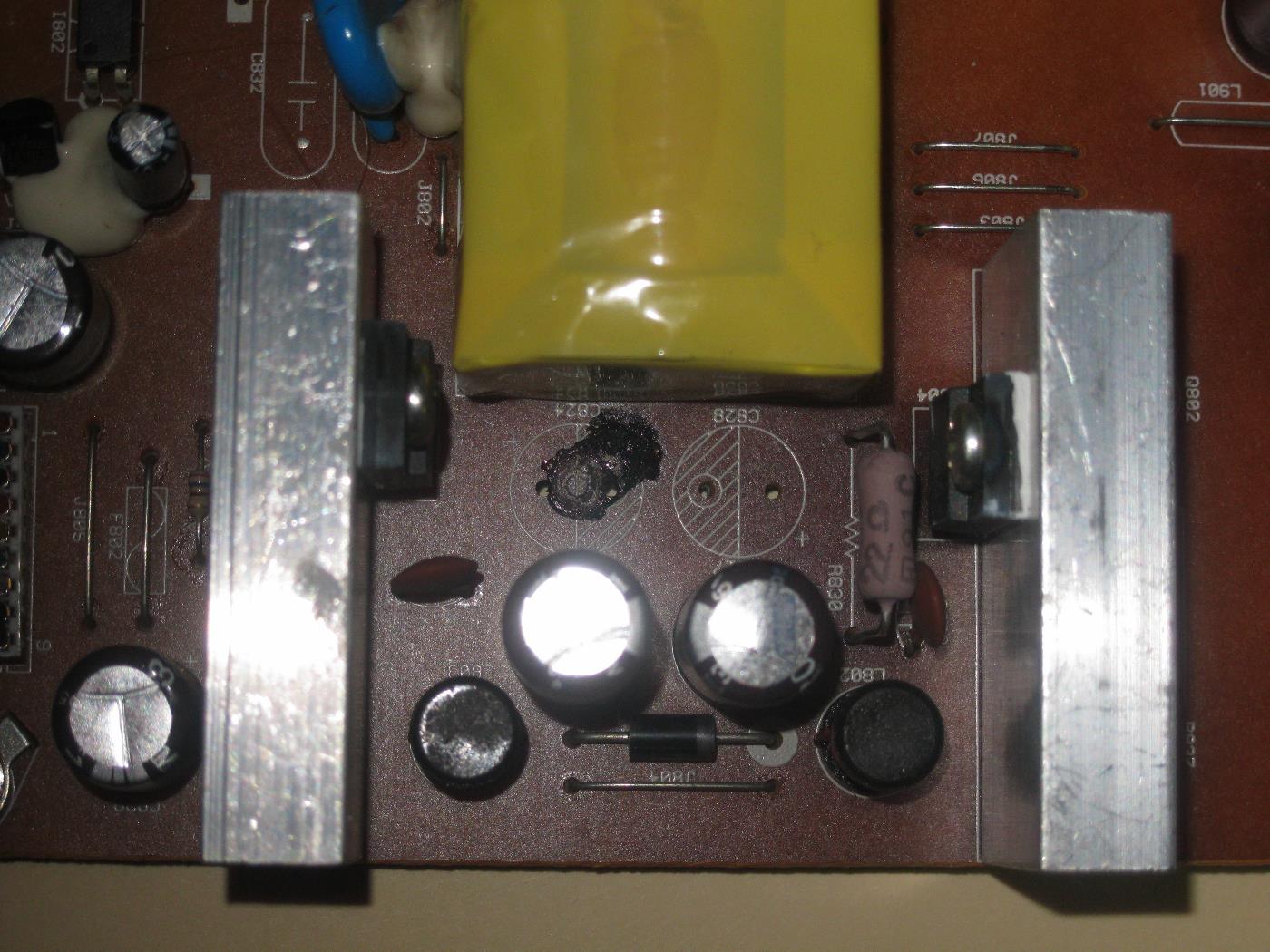

I am posting the pic with the black gook showing on the circuit board after two caps had been removed. I wanted to add that although this is clearly visible now, it was not visible before removing the cap because the caps were mounted very close together so you could not see the surface of the PC board itself, just the caps. So the gook came out the bottom, not the top as i have seen before, so it was a little harder to tell which cap was the worst. I had to judge by the one that looked like it had the highest bulge on top :)
You can also see a slight bulge in the other cap on the right that i did not get to change yet because i have to purchase another cap first. But the set is up and running fine now even so.

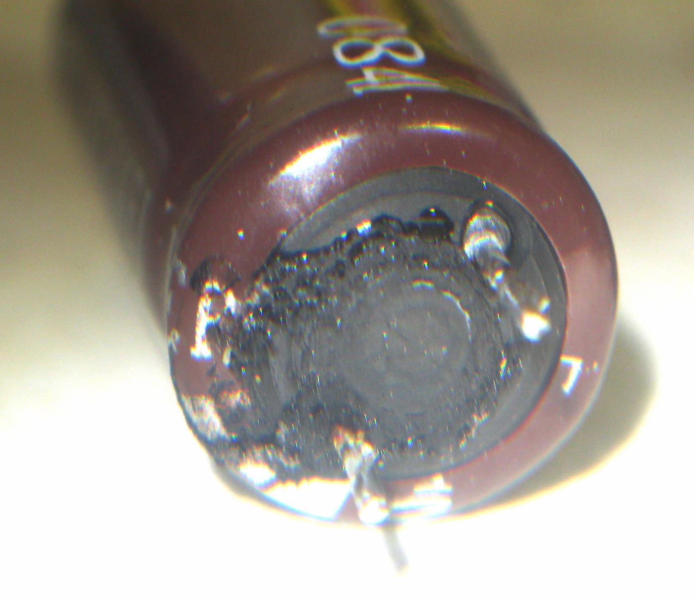

Here's a close up of the worst cap of the bunch, showing the bottom how bad it leaked. Looks really nasty.
It is a Kemet brand, but the only other marking is "0841". I am guessing that is the 41st week of 2008, but that does not help me find the series name identification. The only other info is the value 1000uf and 1500uf and the voltage rating of 16v on both caps, and there is also "LS" which has something to do with the environmental element content. Nothing else though.

The power supply section is on the right, the brown PC board.
I see now that the designer of the PC board for the power supply did not take into account the physical position of those four caps relative to the yellow transformer. The yellow transformer (as any) would get hot, and the heat would rise, and because the four caps are mounted right ABOVE the transformer when the TV is standing in the normal viewing position, the caps get literally cooked by the transformer, especially the ones closest to the transformer. Had they mounted the transformer above the caps instead, these caps would probably have not blown out yet. There's no fan, so the heat generated from any component follows a natural coarse of rising up, and anything above it gets heated not only from it's own internally generated heat but also because of the thing below it. It's so close in proximity too, so that's very bad.
I will be adding a heat shield as well.

The strange thing is the only other capacitor that looks like it is part of a power supply is this bigger electrolytic, and it does not look like it could be a 1000v rated capacitor.
It's the reservoir capacitor, should be rated at 350-400V or so for UK mains, could be half that for only 110V mains.

It's the square transformer at the middle of the far right of the picture, the blue capacitors to the right of that are the 2KV ones, and the four little white plugs are the feed to the CCFL's. The drivers and IC for it are probably SM under the board.
