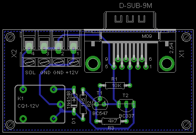

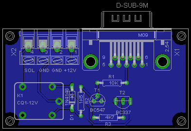

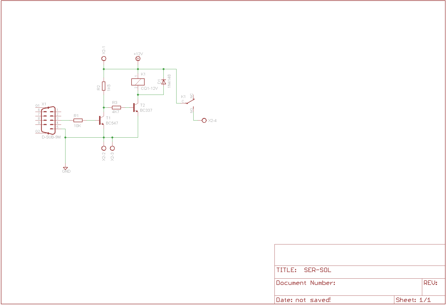

Hi stuee,
I think the pulse can be generated using windows hyperterminal (All Programs -> Accessories -> Communucations -> Hyperterminal)
Here is a circuit suggestion. Board dimension is 2.550X1.375".
Boncuk

I am looking to do the exact same thing. I looked at your circuit and I am wondering what the 4 terminals are. X2-*

If you got a connector you could rob 12v from the pc's power supply, black gnd and yel +12, the solenoid would be ok for just a blip, just put a back emf diode across the coil to prevent any back emf upsetting the pc.
You could use a transistor and a relay to drive the relay coil from the port (or even drive the solenoid coil direct), or if you want even simpler you might be able to drive a reed relay directly from the port, check the current capability of the port is enough to provide the relay with enough mA.

Hi Marc
The X1-X4 are just points on the board. You are simply driving a relay using a transistor. That being the basic circuit. Yes, you could use a 5 volt relay. The only trick is to make sure the transistor can drive the relay used.

Hi Marc
Yes, you can have the different power supplies share the same common (ground). As to a transistor just about any common NPN switching transistor would be fine, for example a 2N2222 can handle as much as 800 mA to drive a relay coil but I would keep it lower than that. Another NPN choice for small relays with low current coils is the 2N3904.
