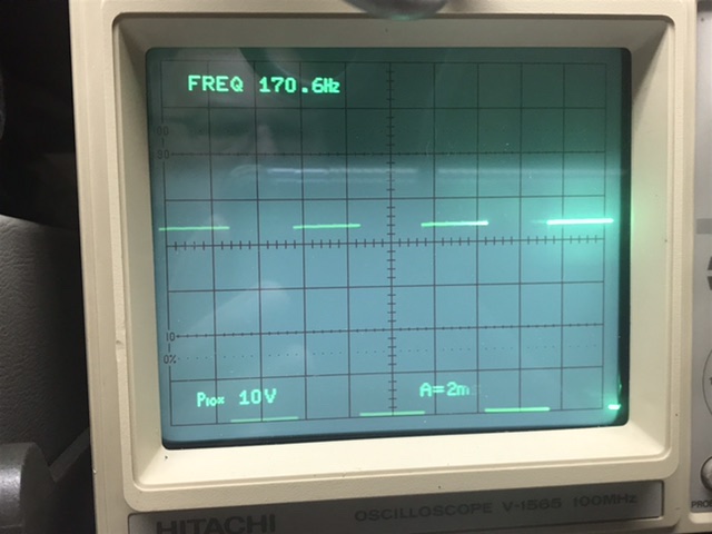

I set it up with some very old school DM7492 and DM7493 chips out of curiosity (wondering if these 45-year old chips work) and it worked like a charm as shown on my 35-year old scope.
you might be able to skip the inverter and 7493 chip if you get the cd4060 to work as your divider AND 32.768Hz oscillator. It should work if you power with 5v.

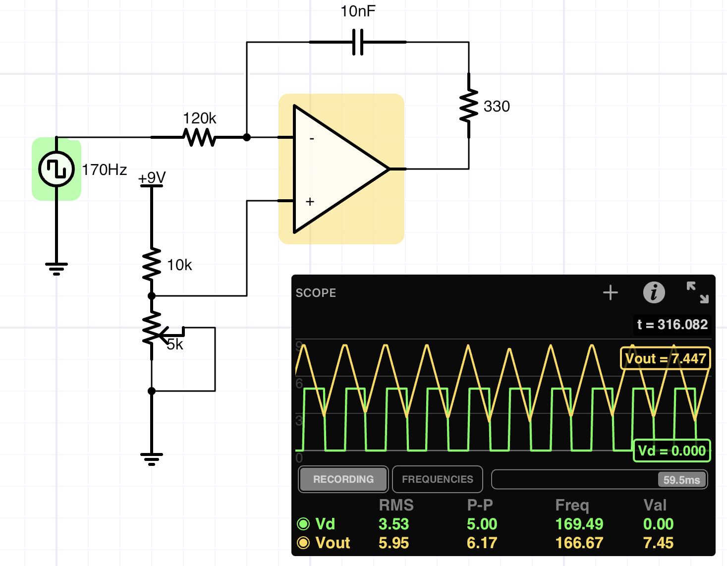

Once again i am here asking for one question related to subject topic, as i asked previously asked previously that i am interested to design a 170 Hz triangle waveform generator by using 32.768Khz crystal oscillator, by your instructions and kind help i am success fully generated 170 Hz wave form but the shape of wave form is not pure triangular, Please find the attached cct and suggest me how can i get pure triangular wave with amplitude 0 ~ 4.5V/5V, what values and topology for RC network is good to achieve desired results. At f2 frequecny is 170 Hz and manitude is 0 ~5V but at output of LF353 (opamp) magnitude is bit lower. already spend too much time but didn't find the solution. please suggest me with your kind recommendations. Specially Thanks to gophert for your great effort.
Your LF353 has an output that will stay about 1 to 1.5v about negative power supply and about 1.5 to 2.0v below positive supply. That doesn't leave much of a range if you are using a 5v supply. The datasheet says to use a 10v minimum (rail to rail) supply voltage).
the "virtual ground" on the + input to the op amp must be adjusted to put center of the output waveform where you want it. The 330 ohm resistor is optional but helps with jitter on the waveform.

iCircuit for iPad + I think it is available as a windows 10 app as well.
all generic parts and supper fast/easy to put something together. It is the only app Iever paid for (5 or $10).

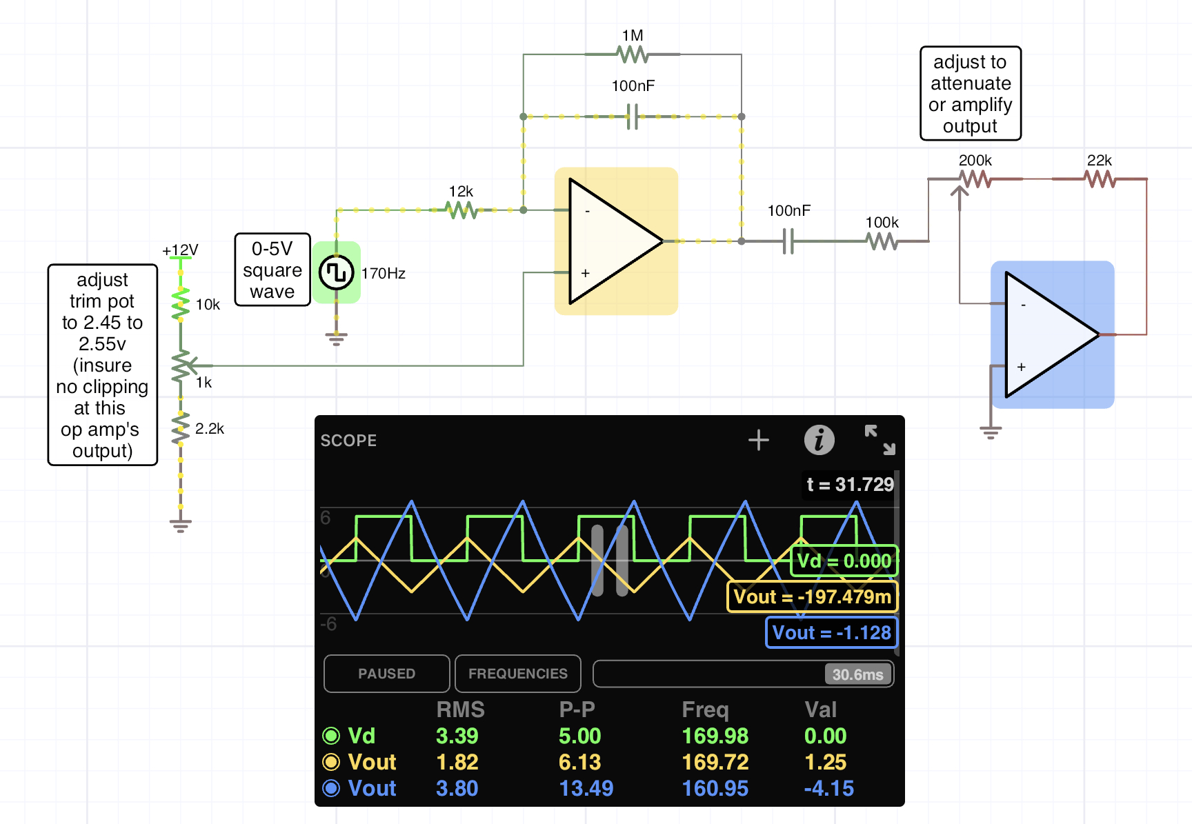

As mentioned in post #19, there are several circuit and component errors that will combine to slowly build up a DC charge on the integration capacitor and eventually saturate the opamp output either high or low. The solution is a DC servo that injects a small current into the opamp summing node (inverting input) to keep the output centered between the rails.

I noticed that. I added the 1Mohm feedback resistor and that seemed to take care of it in simulation (although it adds an ever-so-slight hook to the ideally straight slopes of the triangle wave). I'll set it up to see how simulation and reality overlap. I think I even have a vintage LF353.

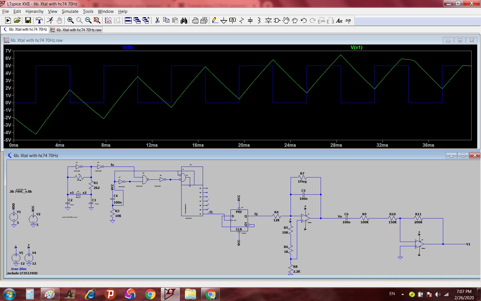

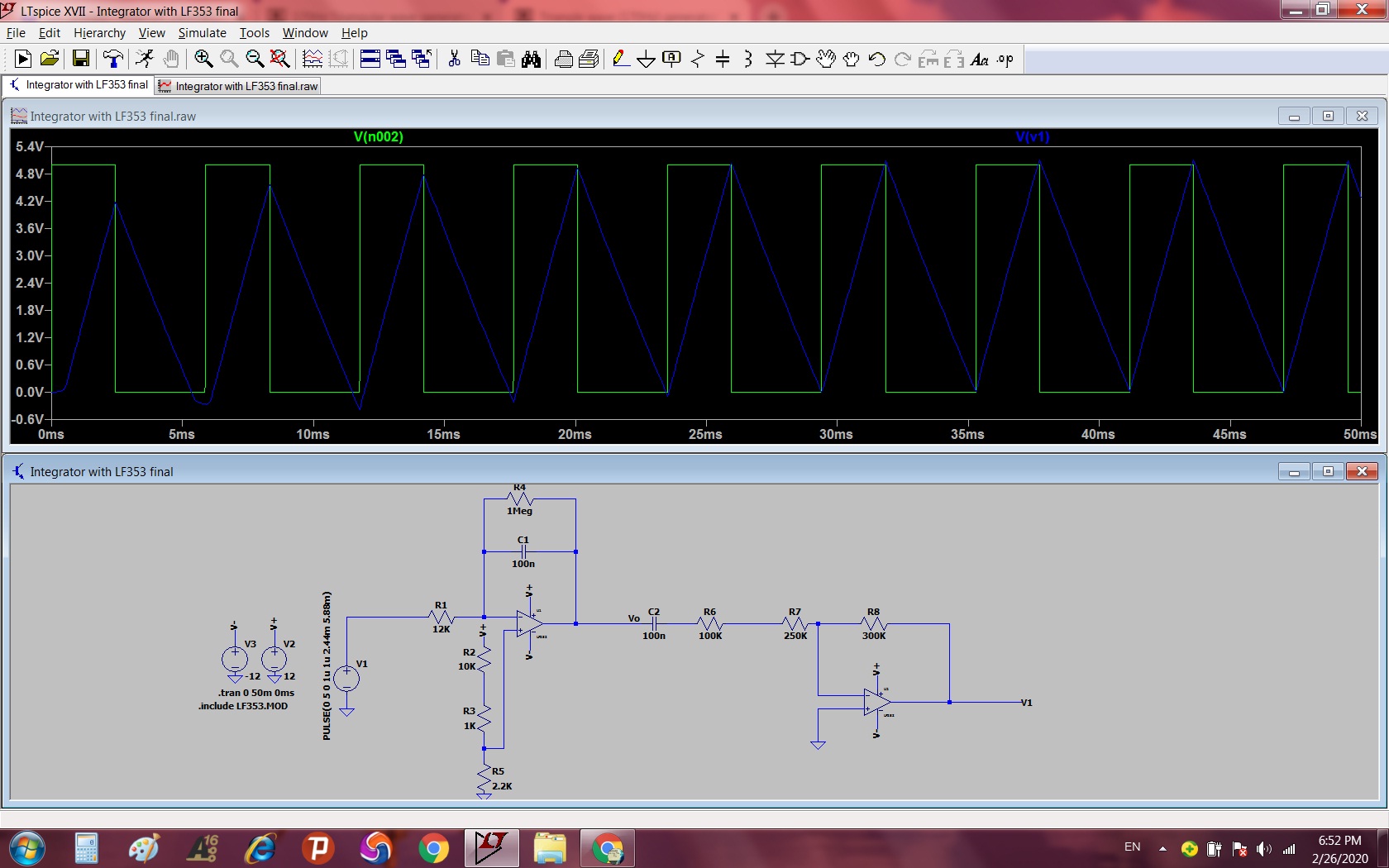

Dear respected gophert,
First of all Thank you very much for your kind help. This circuit is very effective for my requirement. I have designed in LTSpice, and when i start simulation, For initially for 2 cycles of triangular wave was not good and bit low amplitude but after 2 cycles it was stable and works good. For your reference screen shot is attached. But the main problem is, when i connected this circuit with previous cct (mean 170Hz square wave generator by using crystal osc of 32.768KHz) it doesn't work properly, changed the values of variable resistor but didn't found any change at output Triangular wave (i.e. semms like a stare case wave) for your reference screen shot of this simulation is also attached !!! while individually cct works very well.
Please suggest me how can i use this circuitry in right and and effective way.

R6 should be a potentiometer so you can precisely control the midpoint voltage of the waveform. Wire it EXACTLY as I set my potentiometer and adjust up/down until your waveform stays in the middle of your two power rail voltages.
