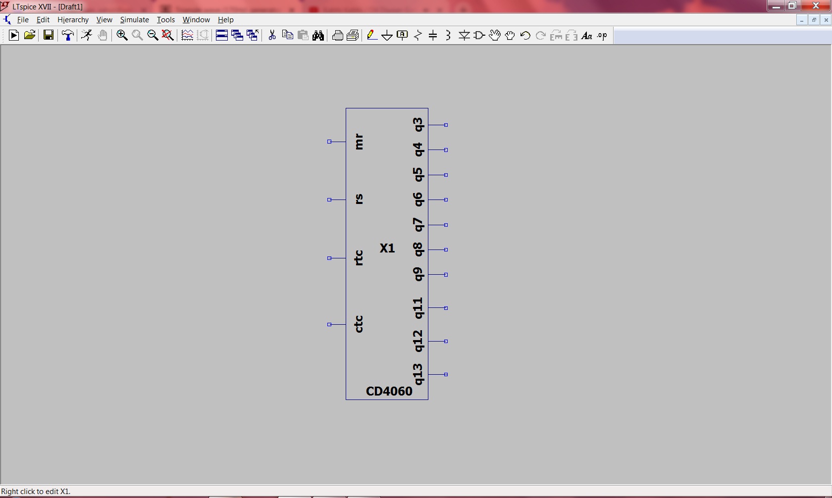

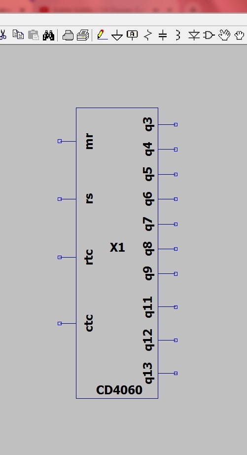

Dear all,
Thank you very much for your help and kind cooperation. Actually i am new in this area as well new for using LTspice software. I am unable to generate frequency of 32.786KHz ... i used crystal oscillator can generate the frequency of 24 MHz .. so how can i generate exactly the desired frequency ? For your reference circuit sis attached, Please suggest me which parameter is required to change to get desired freq ???
