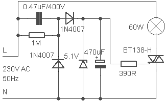

Hi all!
I want to turn on an AC bulb via a logic circuit to TRIAC. Before driving via logic circuit I checked the bulb directly from TRIAC.
The problem is the bulb is flickering.
*I need to turn on the bulb smoothly
*Also it must not be a problem if I swap the Live & Neutral lines
What changes do I have to do?

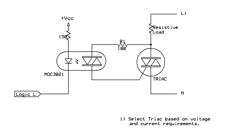

I can't find the datasheet for the H version of the BT138, but the datasheet for the BT138G states a trigger current range of 5-50ma when T2 is positive relative to T1. It has a trigger current range of 22-100ma when T2 is negative. So for it to be reliable, you'd need at least 100ma trigger current for ++ and +- quadrant firing. You have apx 11ma in your diagram.
EDIT: What are you making? If your logic circuit is connected to other devices or a human, then an Opto-isolator like saturn1bguy suggested is the way to go. You can get those with zero crossing built in.

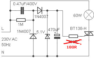

I need to turn on the bulb for 30 mins & off.I removed the logic circuit because the bulb is flickering.So I removed the cct & checked but still its flickering.
Do I have to reduce the gate resistor?
That saturn1bguy's cct have lots of parts.
I want to stop this flicker thing with least amount of parts.

This is the final will it flicker?

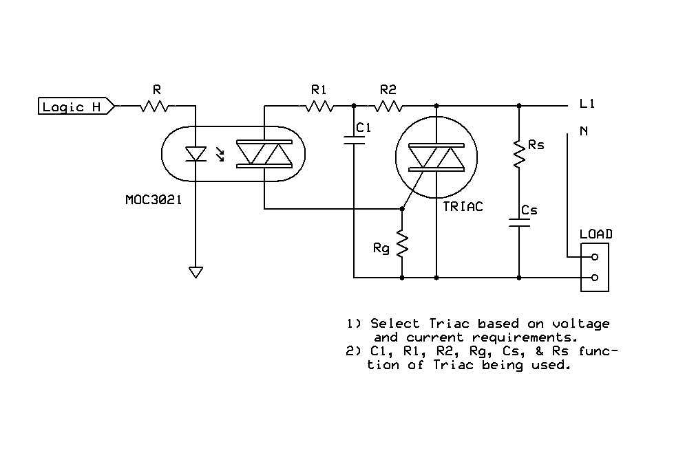

... just to name it: MOC3041
Right, that's good information, certainly. But for his purely resistive load the aformentioned random-phase triac is sufficient, just FYI.

I reduced the gate resister to 100R & the flicker thing was reduced a bit.After long time thinking I solved the problem.
The problem was in my logic circuit it draws more current because it has an LED.After adjusting the LED resister to higher value it was ok so the high voltage capacitor can supply enough current.

And guys please don't introduce opto isolates (MOCs) here because I need to drive it directly to TRIACs to minimize parts.
