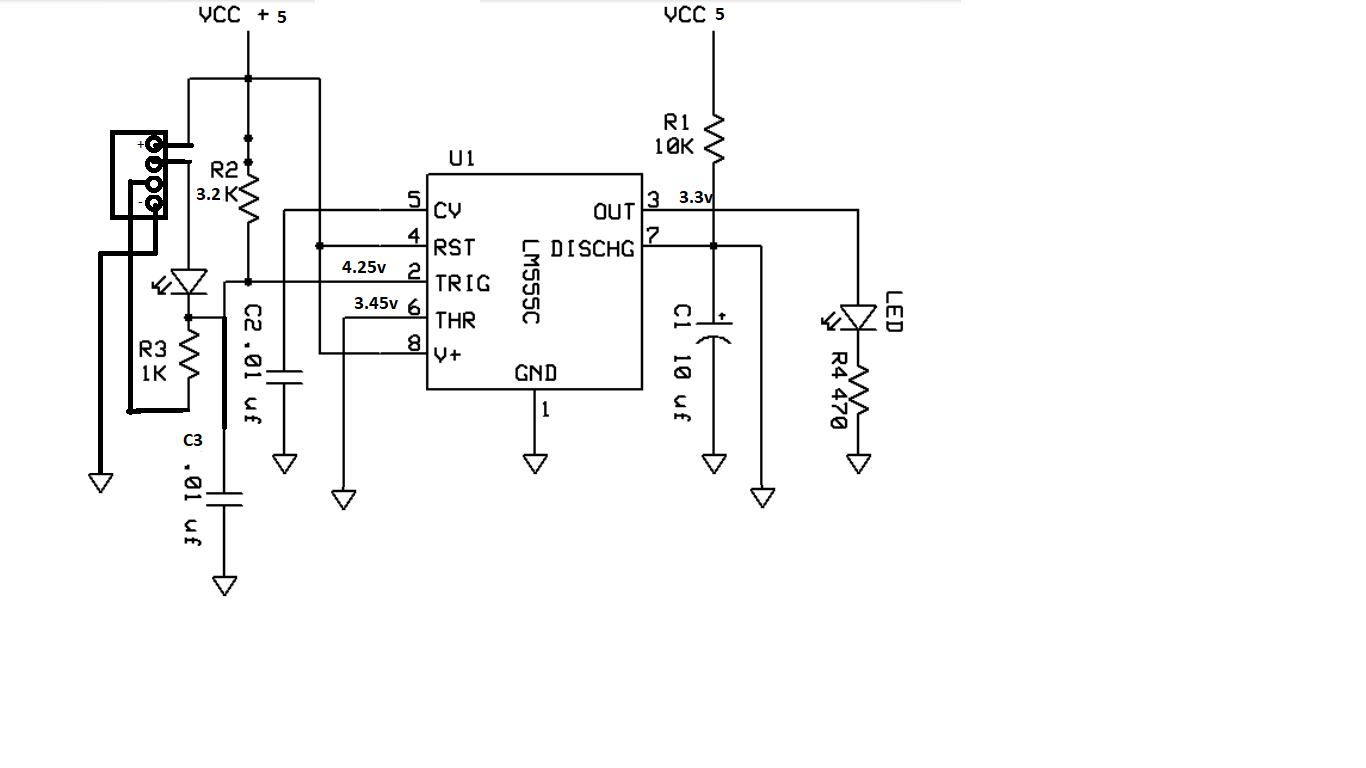

Of course I need a starting point so this schematic is it. (originally a fake Geiger counter) I bread boarded this and of course both leds light but LED2 (regular LED) is not flickering. Ive noted some voltages so you could help me get the right resistor/cap combination to hopefully make both LEDS flicker. The desired effect is while the flickering LED1 pulses it triggers the mono 555 at pin2 and this makes LED2 flicker but slightly out of sink from LED1 giving the illusion of a candle.

It has 4 pins. outside pins are power. Inside pins are the led. Ive modified the schematic to show the connection.

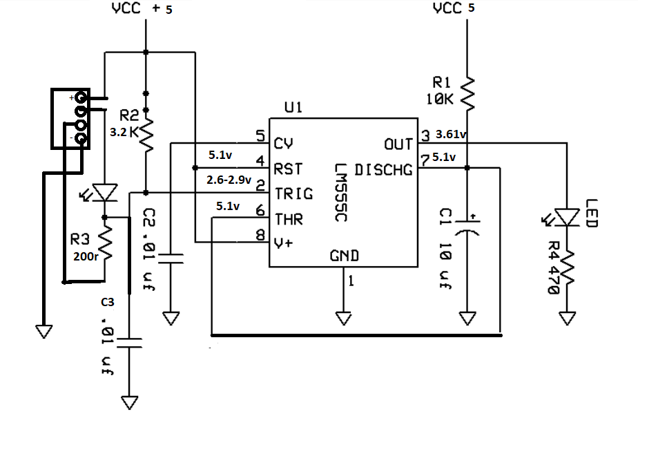

This is the schematic. It was suggested to place a .01 cap across R3. I dont know what that means so i put it where i thought is should be.
The current state of this circuit is the LED2 is lit but it does not flicker. I need assistance making it flicker.

Let's start with this. Can the 555 respond to the output from the "flicker"?

But yes, the 555 can be triggered by capacitively coupling a low going edge to the trigger pin, which will cause the output of the 555 to go high. You can configure the 555 as a one-shot, in which the output will go low again after a delay, but I don't think that will conform to our definition of a flicker.

i only have a multi meter. I have not hooked this generator up to a speaker but im almost certain its flicker effect is based on a song passage. I can see through my DMM the voltage go from 2.6 to 2.7 almost in a pattern. I would say that the slight variation is not enough to register with the 555. What say you?
The the internal flip-flop of the 555 is set (output goes high) when the trigger pin goes below 1/3rd of its Vcc voltage. It stays set until the threshold pin goes above 2/3 of Vcc.
You can use a resistor divider to set the trigger DC level just above 1/3 Vcc, then capacitively couple your source to the trigger pin. But what do you want to happen then?
The original author had a speaker connected to pin 3. each time pin2 was triggered a tick sound would play. sounded like a Geiger counter. The additional led at pin3 also "flickered".
I understand that the right combination of resistors are necessary for the 555 to be able to respond correctly. I just do not know how to figure out what they would be. The original design was powered by 9 volts. Mine is connected to 5 volts.
The way it is configured now the 555 does respond to the led on pin2 as the led at pin3 does illuminate, It just does not blink as the original authors did. If i remove the connection at pin 2 the voltage goes high (5v) and the led at pin3 does out. when i connect it back the voltage drops to 2.6 (low) and the led at pin3 illuminates. the issue is that the led at pin3 remains on (solid) no blinking or flickering.
