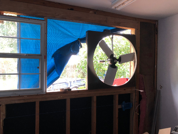

I would like to use whole house fans to ventilate my workshop but it would be nice if I they were computer controlled variable speed.
I have done zero crossing, triac thing, once or twice back in the dark ages but never for an inductive load so I am asking for advice.
Suggest circuit/schematic. if not what do I need in the way of a snubber?

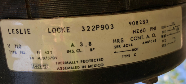

Do I want to just use the high speed wire or should the low speed wire be used for lower RPM? Thinking that using the lower speed wire will be more effective at low speeds because the triac can be triggered sooner for a longer on period.
Random info
A PIC or ESP8266 will be used for this controller.
As I understand either 2 separate sets of poles or a transformer is used in motors like this to obtain more than one speed. I have no idea which it is.

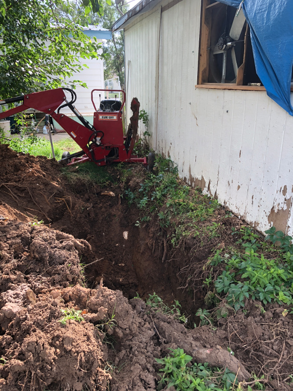

That looks like a rotary guillotine waiting for a victim. I hope safety screens smaller than a child's hand (finger?) are a part of this project. I also hope I don't hear, "children won't be here" because children eventually find there way everywhere - even if it is the day after you start "pushing up daises".
This greatly concerns me too. I've opted for a 5 foot deep moat rather than a screen. That way I can stock it with alligators. Well still dithering between gattors and crocks! :)
Current plan is to construct a metal frame for the fan with grills on both ends. Am looking at having the frame rotate so I can reverse air flow.

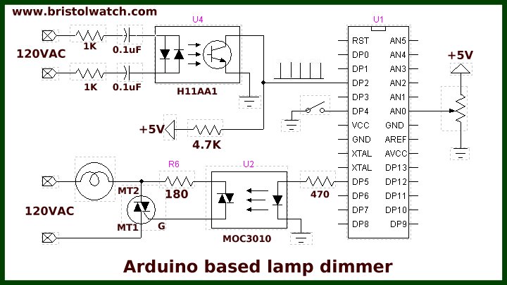

For uP control you will require an optocoupler. Make sure that you select a NON-ZERO CROSSING device. Using the incorrect optocoupler is the number one error.

Thanks Schmitt trigger. Looks like the H11AA1 opto coupler is a reasonable choice on the optocoupler to do zero crossing detection as shown here. Reduce the 4.7K and 470R current limit resistor if I go with a 3.3 V processor. Was concerned about the caps connected to the mains but found KEMET R75LI3100AA00K "Film Capacitors 560V .1uF 10% " for 34 cents each.
If this is reasonable all I have left to do is find a reasonably priced triac with sufficient headroom. Motor says 3.8A so maybe 2X or 3X that. So 8 to 12A.
I have previously used the H11AA1 to detect zero crossing. It is a good choice.
But I have always employed purely resistive current limiters. The capacitive limiter will introduce a phase shift with respect to zero.
Lastly, try to get the MOC3011 optotriac. The MOC3010 requires significantly more trigger current, and may not work reliably with the resistor value shown.
