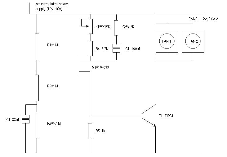

It is not that I doubt your circuit, but could you post your circuit AxelD. I think it would help everyone here out a lot more if you did. Is your V(ebo) greater than 5vdc? If so transistor is no good for that voltage.

I will post the circuit later - need to draw it up in word or some other program :).
B reagle - im not too sure what you refer to by V(ebo). According to my calculations, the base voltage of the transistor is max 2v (base to ground). The voltage i measure from the collector to emitter varies from 0.5v to 12v.

Heres more or less my full circuit. Im a newbie so im sure there are a quite a few mistakes. Go easy on me ...
Now that the transistor issue is sorted, the next issue i have is that im running the fans off a switchable wall transformer (3v,4,5v, ... , 12v) thats not regulated so the voltage varies between 12 and 15 volts. What is the best way to get better regulation given the 12-15 volt swing? 7812 or 12v zener?

What is M1? it looks like a Mosfet. What does it do?
When you turn on the power to the circuit with the speed set low then the fans might not start running because the starting current is more than the running current.
The circuit does not need a voltage regulator. When the speed is turned down and the voltage increases then it doesn't matter.
https://www.fairchildsemi.com/ds/TI/TIP31.pdf is the datashhet I looked at, and in the first chart is where V(ebo) is. I got 5.36V max by using I(total)=V(max)/R(total)
Which I used 15V and 2850ohms=5.35mA
V(r)=5.35mA* R
Which I used 1k for R
And I got 5.36V on the base to common.
R(total)=2850ohm to 3913ohm (on the base)
I am a little rusty with this math. I hope it is right!!
Again I am not sure if this is right.
