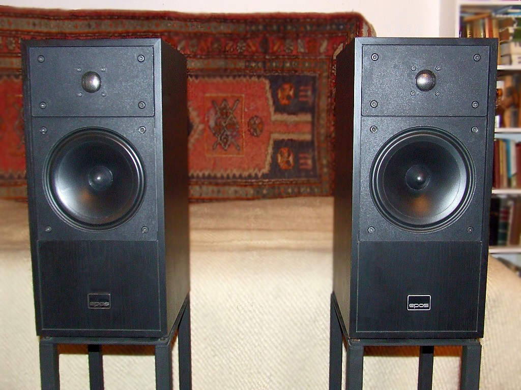

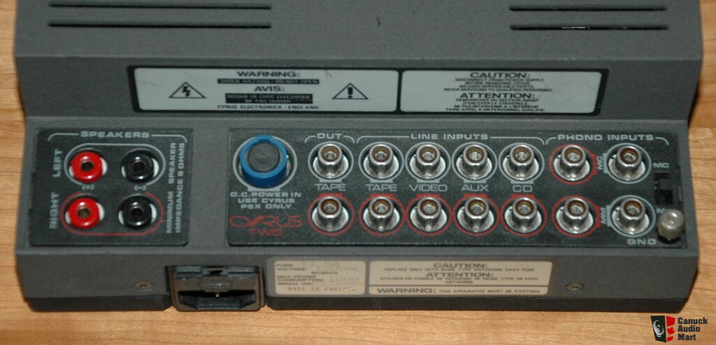

My son's system at the time was :
(1) Amp: Mission Cyrus II, 40W but 20A current capability (I think). Separate PSX2 PSU.
(2) Speakers: Epos ESP14s. Custom 6.5 inch bass/mid driver and custom 1 inch metal dome tweeter. 1 capacitor and 1 resistor xover. Mounted on some good, but not overly expensive stands.
(3) Speaker cables: mid priced (can't remember make and model number)

Hell, did his system sound good. The bass was amazing, especially for such relatively small speakers: extended, articulate, and plenty of slam. The metal dome tweeter, also custom, was xtal clear and detailed to the extreme and could cut through to your brain if asked to. As I have said before, we did a megga system shoot-out at a friends big place in the country. Everyone smiled when my son, who was only about 17 at the time, se up this tiny amp and 'little' bookshelf speakers with their funny stands. They were in for a shock.

  • Cyrus 2 service manual_mod_reduced_2015_12_07.pdf
