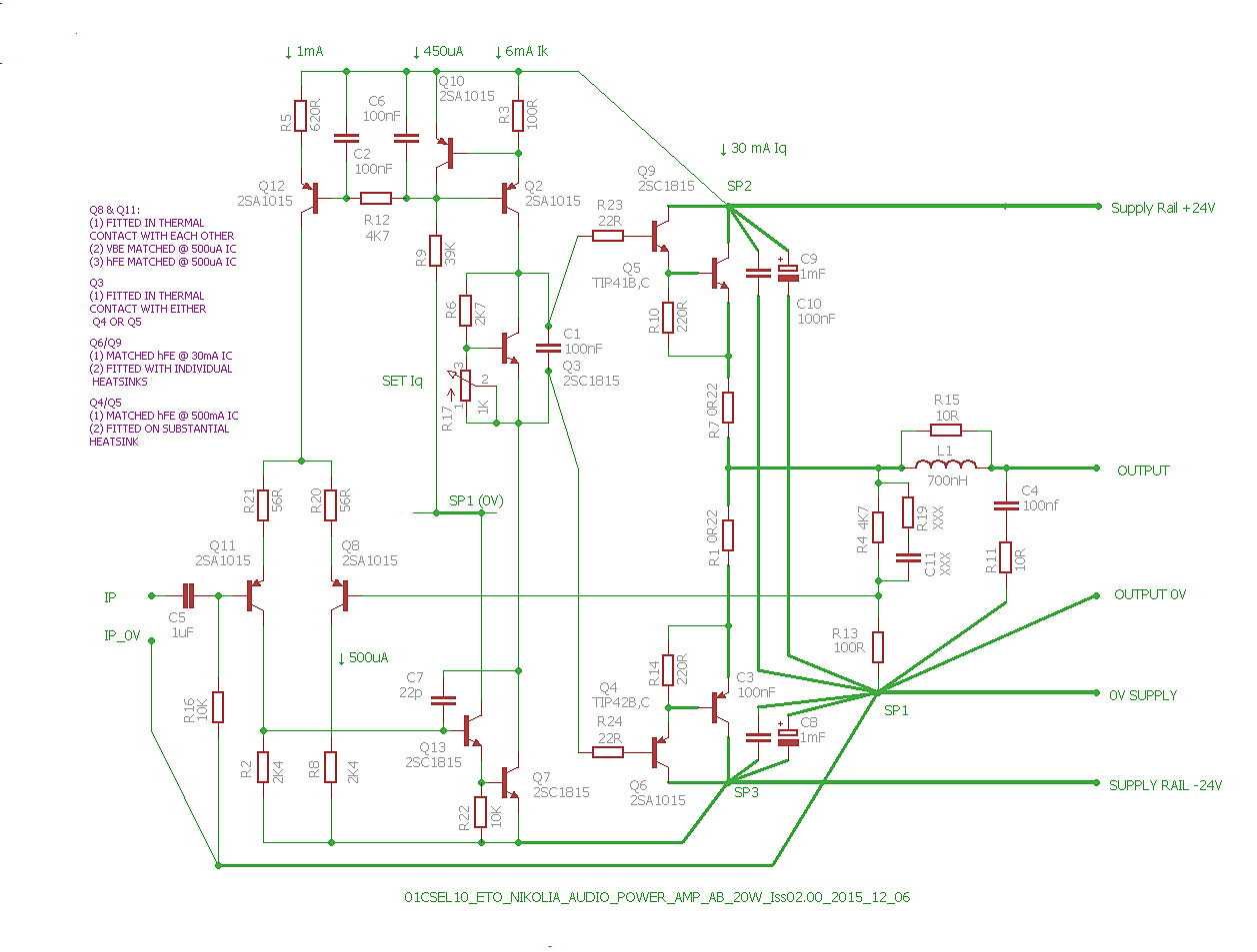

About the power amp
(1) 8 Ohm speakers?
(2) single supply rail or dual supply rail?

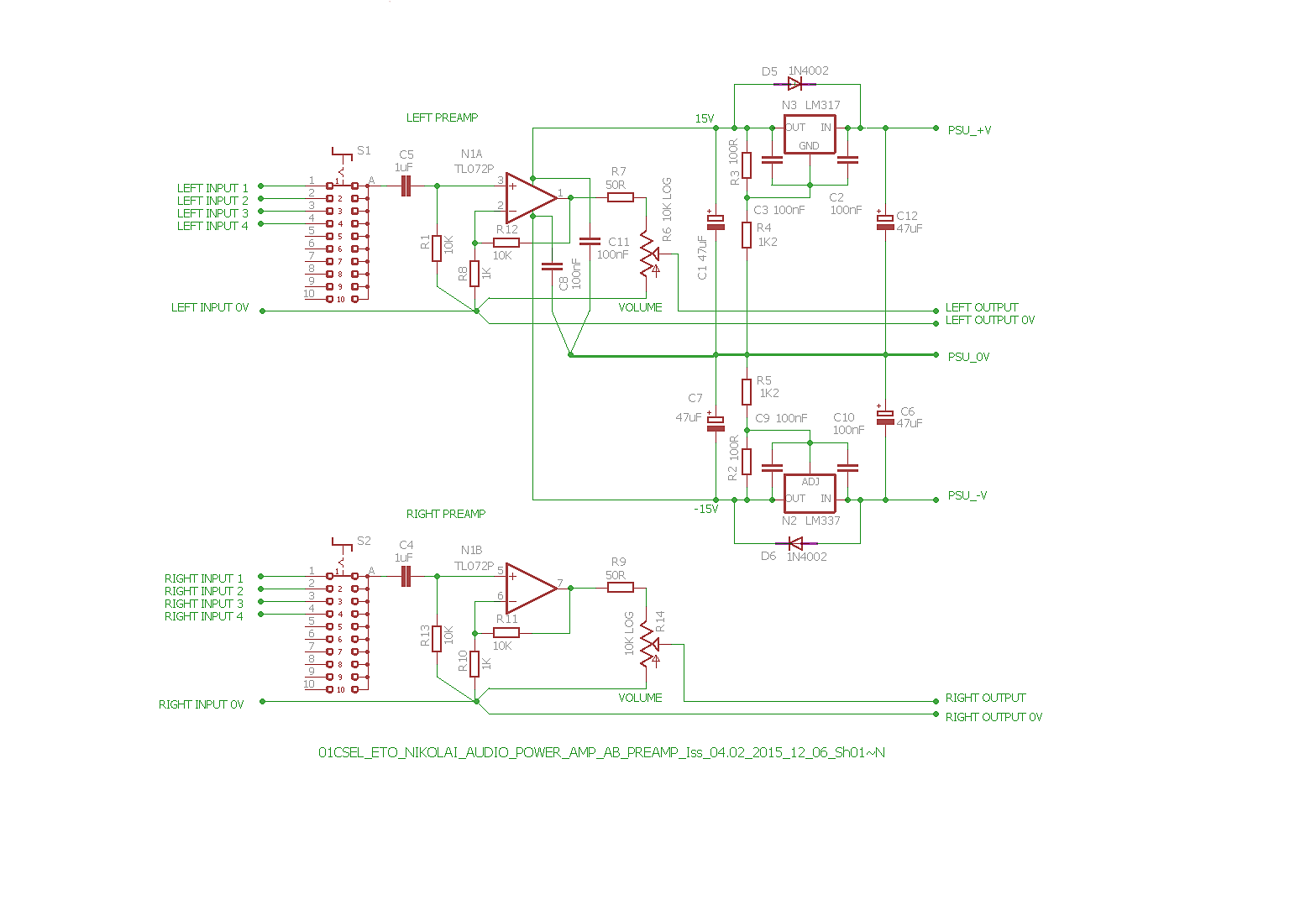

About pre amp
(1) What input?
(2) What controls?
(3) Opamp or descrete transistor construction?

Hi Nikolai,
The NE5534, is not available from your supplier. Thats why I used the TL072. The TL072 is designed for hifi and sounds ok. It is slightly smooth and pleasent sounding. With the basic circuit, if you fit an IC socket (turn pin) you can then try, more or less, any opamp, including discrete, like the Buriston amp. I would suggest that one of the audiophile opamps would be bar far the best- they sound superb. I will post a list for you to have a look at. But suggest starting with a TL072 to get the system going.
If the power amp is too complicated for your liking it can be stripped down to the basics. But when you lay out the PCB alow for all the circuitry so you can upgrade later. The only way to test an amp, after the technical side has been sorted and it is running reliably, is to listen to it on your chjosen speakers.
By the way, never connect an amp that hasn't been proven to your speakers. Get a nice big 15 Ohm or so resistor and put that between the amp output and the speaker- I say this from experience!
NE5532 still available, but this amp will need preamp? Or the preamp is necessary? If make preamp, I would like it is a tone control 3-5 bands
NE5532 still available.
Are you saying that you want to use the NE5532. If so, no problems. Let me know and I will have a look at that.
The audio power amp can be used without a preamp; it all depends on your signal source.
OK , but tone controls equilisers etc, not good for hifi.
Tone controls can adjust the sounds to the way you like them. Maybe the original recording or your speakers has/have too much high frequency boost or cut, midrange boost or cut and/or too much bass boost or cut.
Every radio and TV station sounds different and tone controls can make them sound better. Use 5 bands only if your speakers are really bad.

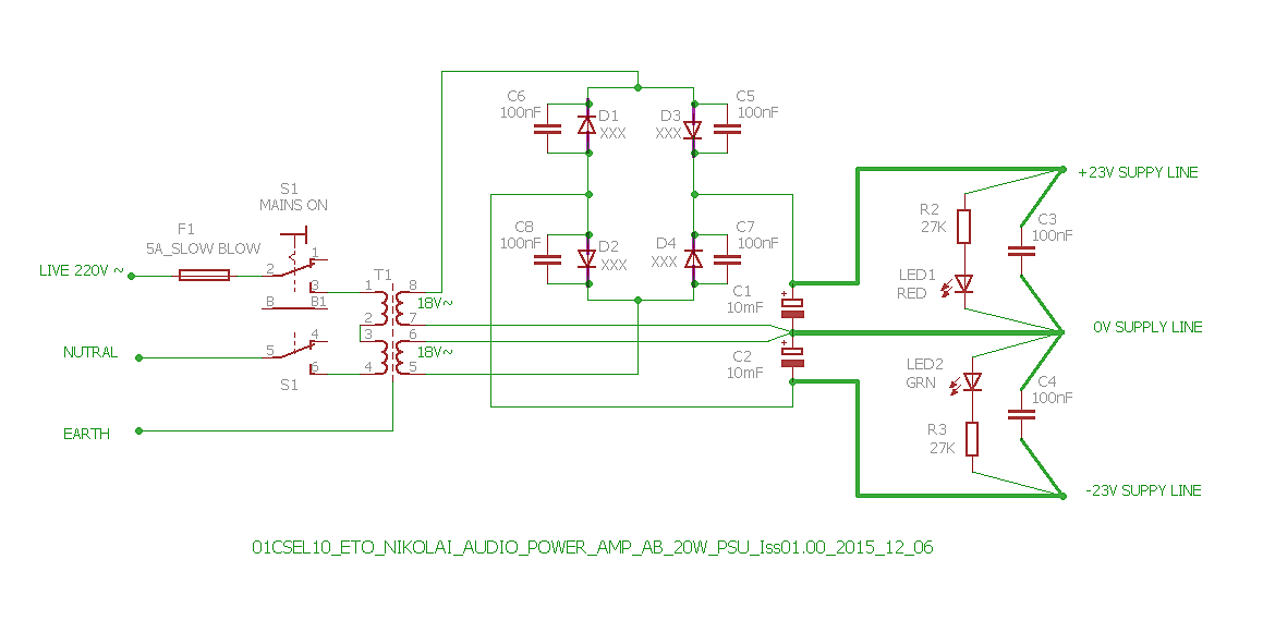

Generally, you don't fuse neutrals. Not sure about rules in Vietnam. You "generally" don't fuse Neutrals, but only one system (in the actual device) I ever worked on fused (had a breaker) one in the US. 3 phase (90 A 208 V) with neutral and ground. Power out was at least 15 kV at 1.5 A. Open for discussion.
Hi Keep, I'm not sure what you are saying about fusing neutrals. The various PSU scematics I have posted only have a fuse in the live line, which is normal practice as far as I know. Are you looking at the double pole switch which disconnects both live and neutral. Perhaps I have used the wrong symbol- it is only supposed to be a double pole double throw mains switch, which is pretty standard.
