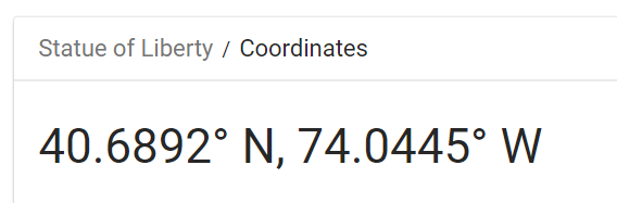

Without giving away your personal address. Let me show you how I came up with the answer.
My address for this example is the Statue of Liberty in New York.
Go to Google.com and enter "statue of liberty gps coordinates" <Enter>
Google returns the below image.

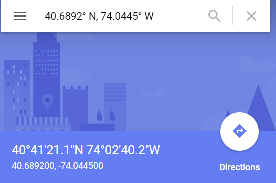

Next copy the GPS coordinates into Google Maps
Google Maps displays as below.
The bottom set of numbers are the longitude and latitude of Lady Liberty
Now using the lower numbers enter those into the Noaa solar calculator.
https://www.esrl.noaa.gov/gmd/grad/solcalc/
After you enter the Longitude and Latitude in the calculator hit the "tab" key to update the data.
Let me know if that does not work for you.
