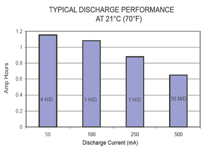

The higher the current drain, the less capacity such batteries exhibit. The 1200 mAH rating is at a drain such as 50 mA.
Here is a chart from Duracell for its Coppertop battery:
Here are the links. The first is to Duracell technical data. The second is to the AAA Coppertop. There are differences between manufacturers and for products within a single manufacturer. The highest capacity rating was at 50 mA for 4 hours per day.
https://www.duracell.com/en-US/Glob...ets.jspx?icn=AdLob/ProductDataSheets&cc=AdLob
https://www.electro-tech-online.com/custompdfs/2013/02/MN2400_US_CT.pdf

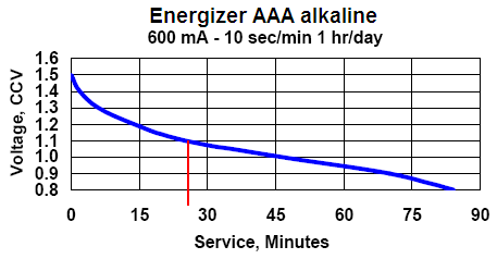

The voltage of a tiny AAA alkaline cell drops like a rock at 600mA and drops faster with a higher current.
