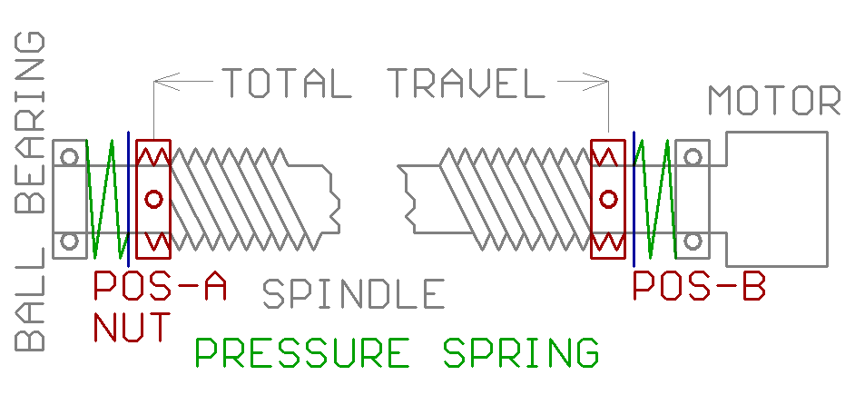

I guess precision in camera movement is not required down to 1mm with each motor start.
The mechanical drive would then use a threaded iron rod (M3 through M12 available at home markets and use a slider carrying the camera on a nut traveling along the thread.
To avoid jamming of the drive you might remove the thread and use pressure springs to press the nut towards the thread. (See attachment)
The timer should consist of two parts: Trigger circuit (adjustable from 1 to 30 seconds) and motor control circuit (adjustable)
Boncuk

I don't know the lenght of the rail system.
Using a stepper motor and apply a defined number of step pulses each time the camera has to be moved eliminates the need of countless sensors along the rail.
Having the sensors mounted at fixed positions is probably not what the OP wants. Using a lead screw makes the drive universal.
