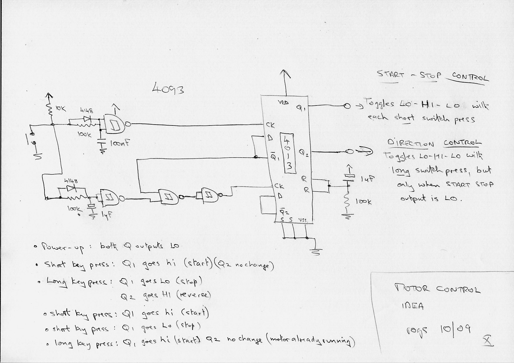

What about something like attached sketch? Simpler than my previous effort (sorry you didn't get it to work!).
Just an idea.

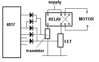

Here is a block diagram of the circuit.
The 4017 is driven via a flip flop already contained in the original design. Each time the switch is pressed, the flip flop changes state and each two presses increments the 4017.
On the first output the relay is activated. Pressing the button two more times activates the FET and the motor revolves clockwise.
The next increment of the counter turns off the FET.
The next increment o the counter turns off the relay.
The next increment of the counter turns on the FET and the motor revolves anti-clockwise.
The 4017 then cycles to the first output after two more presses of the switch.
Sorry, I'm none the wiser!
To me it looks as if you are trying to energise a relay coil by directly sourcing from a 4000 series CMOS output. Interesting concept.
Perhaps a little more detail, with one or two short descriptive notes on sequence function? (As I have on my sketches).
I see you've edited your previous post, by adding the descriptive notes afterwards, so that my post above now appears to criticise your lack of description.
When I posted there was none - just your 'block diagram' (which actually seems to be part of a 'circuit diagram', but with no component details).
Still intrigued by the attempt to energise a relay coil, by sourcing directly from 4000 series CMOS.
By the time you have added the extra componets, to actually allow this circuit to work, I don't think the idea of 'simpler' will any longer apply.
And again, a further edit! -this time to correct the CMOS drive error. OK, I surrender -there's no point in trying to maintain a post sequence, if you continue to make retrospective corrections to your somewhat unusual 'circuit'.

Using the 2 flip flops in the 4013, as per my second sketch, allows you to ensure that the motor can only be reversed if it is stopped.
You might have a bit more luck by using the HEF4013: HEF4013 Datasheet pdf - Dual D-type flip-flop - Philips
It has Scmitt triggers on the clock inputs! :)
