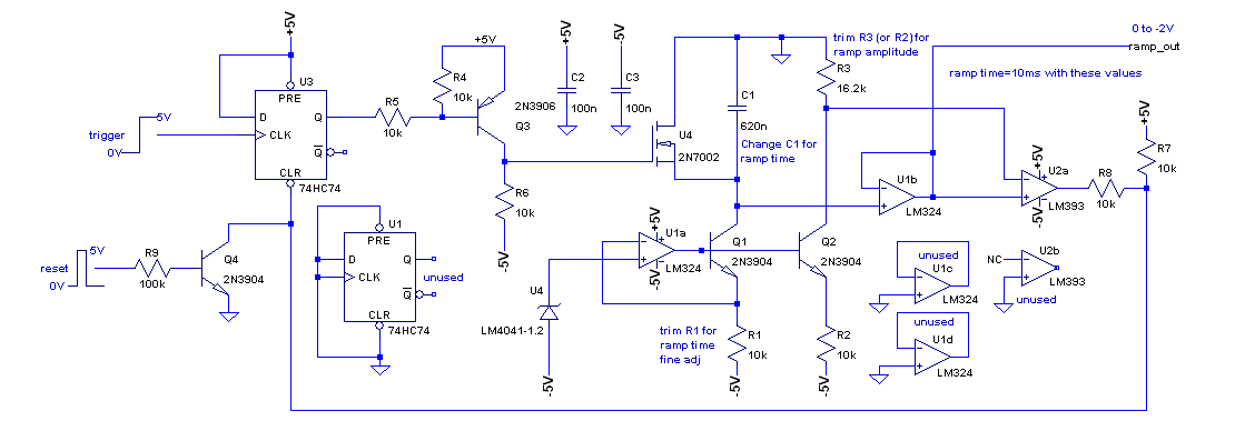

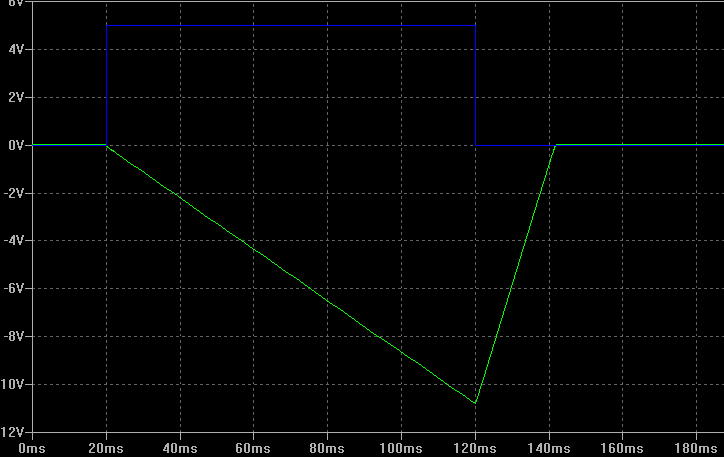

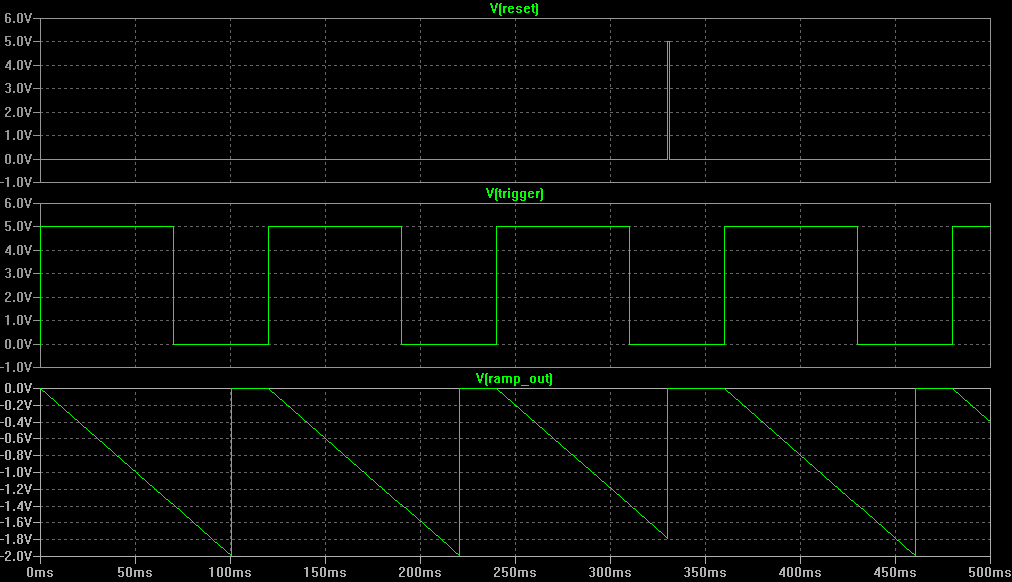

There may be a simpler way of doing this, but this should work. You didn't mention the time duration, so I used 10ms, but you can change C1 as noted in the schematic. I simulated this.
EDIT: Added plot. C1 was changed to 6.2uF to get the time to 100ms. A better solution would be to reduce the current and make the cap 1uF or less.

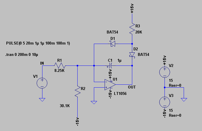

Hi Dknguyen,
Something like this ?
It was only a simulation, I never built this ****.

Yeah, like that. Except when I look at those circuits I have no idea how they work! I don't have a very good analog intuition. It's supposed to quite a minor part of the circuit and it seems Roff's is quite a major part! I'm starting to appreciate something like a a PWM DAC right now, but I will sit down with these circuits and stare at them for a while. THe ramp time is 100ms BTW.

I added a plot to my previous post. I agree that a microcontroller and a DAC of some sort would be better. I also considered an integrator (as on1aag did), but concluded that a current source with a discharge switch (the MOSFET) would give less zero offset, and faster reset time.
Oh, is that what your circuit is? A current source charging a capacitor? I got lost in all the transistors and op amps everywhere. I was thinking about a current source (using a negative regulator or something). At first I was trying to charge a capcitor through a resistor but it wouldn't be very linear and the charging voltage would have to be about double or so of the maximum ramp voltage to keep it linear-ish. I dropped both ideas though because I ran into the problem of the bias currents on the amp's gain control pin being larger than the capacitor charging currents due to the small value of precise capacitors.
On1aag's integrator is actually a current source charging a capacitor also. Just another way of doing it. His circuit either has to be controlled open loop, as he has done it, which may be OK, or it also needs the comparator and the flip-flop. I think you said you wanted it to be edge-triggered, That's why I put in the flip-flop, and the comparator to detect when the ramp reached 2V so it could reset the flip-flop and the ramp.

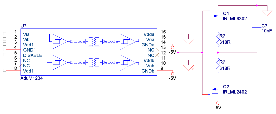

It's just that I wanted to having an actual continuously varying gain, though now that I've seen the complexity of it, I am considering just using a PWM DAC.
THis is my PWM ADC circuit. It has to be isolated anyways since the electronics on the DAC side of things are not isolatable from the 200V signals running around. And it helps me use a 0-5V signal to switch transistors with 0 and -5V power rails.
I figured the resistor placement would be a nice way to use the filter resistors to control shoot-through too so I wouldn't need fancy dead-time control (although I suppose I could do it through software anyways since I could just control the FETs separately through the gate driver by splitting up the gates and connecting them to different drive pins on the IC.
Does anyone see any problems?

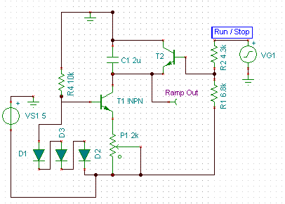

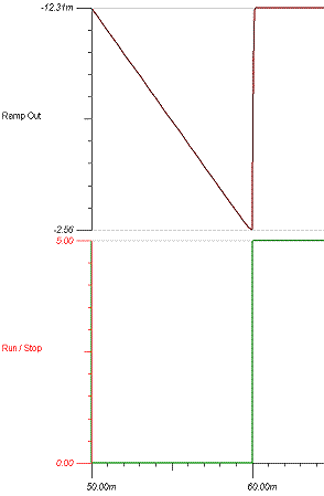

Hi All,
This is probably coming in slightly late, but would a circuit like the attached not be a lot simpler?
The Run/Stop signal could be generated from a PWM on a Microprocessor, or a 555 running as a monostable. With Run/Stop held high, the output sits at 0V, when it goes low, the cap charges until it hits the current sink's compliance, or until Run/Stop goes high again.
