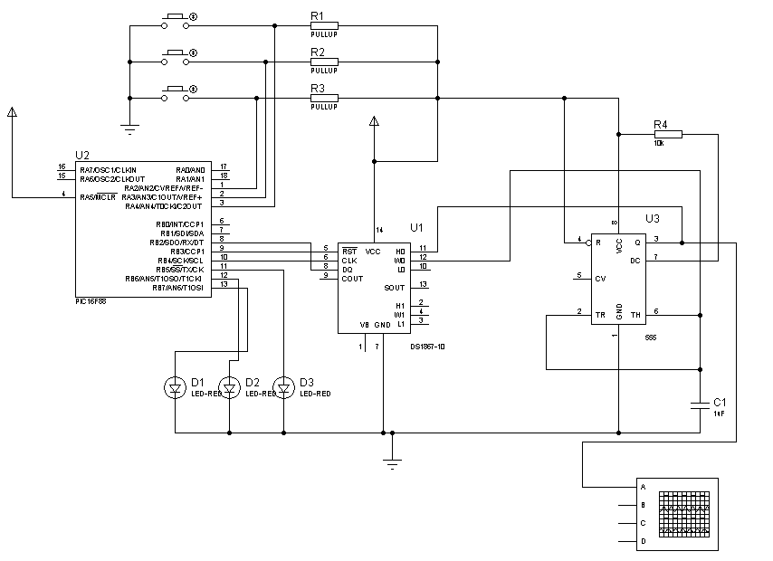

I am trying to build a simple project which I use a "PIC16F88" communicating through (SPI) with a digital potentiometer DS1267-10 to control the oscillation of a timer 555

The problem is: the oscillator only oscillates at one frequency, by pressing the buttons it does not chance the oscillation speed. Not sure if the problem is on the circuit or on the code. Any idea?

You're using only the H0,L0,H1,L1 pins of the dual pot. The resistance between those is fixed. You need to use a wiper pin (W0 and/or W1).
Your code only has 8 bits.... There should be 17 bits SB, W1bits, W2bits..
I assume you are trying to use stacked... You need to redraw your circuit as well..

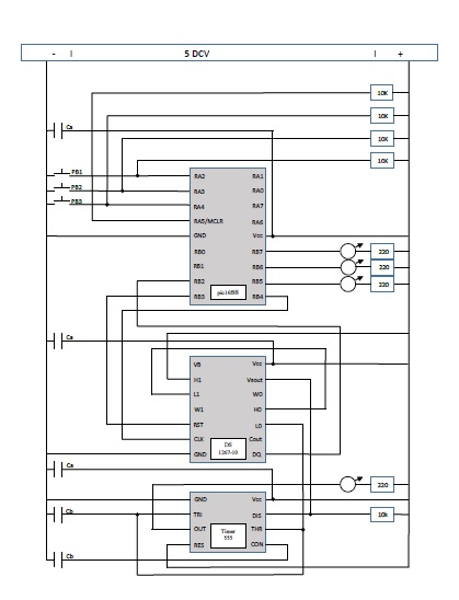

And the circuit.... NOTE 555 ouput needs to go to the top of the wiper as you are trying to keep a 50% duty cycle..

And the circuit.... NOTE 555 ouput needs to go to the top of the wiper as you are trying to keep a 5% duty cycle..

True, this is just an exercise eventually I will remove the timer 555 and connect the pic and digital pot to a motor controller which is controlled by a variable resistor. The timer is just a way to see how the resistance changes, main focus is on the digital pot using a microprocessor (pic).
I forgot to mention the configuration of the digital pot DS-1267-10 is stack, which puts in series the two resistances inside the chip and the output is on the Sout (pin 13) instead of using the W0 or W1. The datasheet is not very clear but I think it says that for stack configuration it uses 9 bits of resolution.
