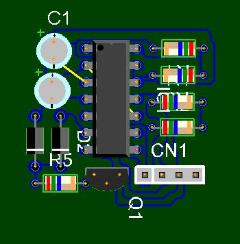

This is the prototype I put together with expressPCB. Can someone verify that it is correct for me? I'd hate to go burning this and find out it's wrong :)
P.S. I modified it a bit. R6 is a 330k resister, L1 is an ultra bright LED. I also changed the power source to a USB port, which changes the +3v to +5v.
Bottom Layer
Top Layer
Both Layers with Part ID's
Color Traces with Components
Thanks in advance!
Adam
Using a 330K for R6 will not drive the output transistor hard enough.
Where is L1 on the original circuit.
The +3V to +5V will have little effect on the circuit.

As I said, I modified the original circuit to include these components. L1 and R6 aren't in the original circuit. R6 doesn't have any effect on Q1 (NPN Transistor), that I can see.

I can post the .pcb file, I don't have an .sch though, I just jumped in to ExPCB and drew it up :)

I take it you don't see any problems with that circuit?
