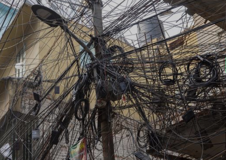

In my country, a mother died along with her daughter, whom she was holding in her arms while cooking rice in a rice cooker. She plugged it in and got electrocuted. What can be the reason behind this electrocution? Where might the fault be?
You're Bangladesh?
You can start with lax inforcement of people stealing power with illegal splices into the grid. If the taps into the grid are not authorized, there is likely no inspection, no circuit breakers, no grounding, no GFCI, ...
It's sad but you get what you enforce (or what you don't enforce).

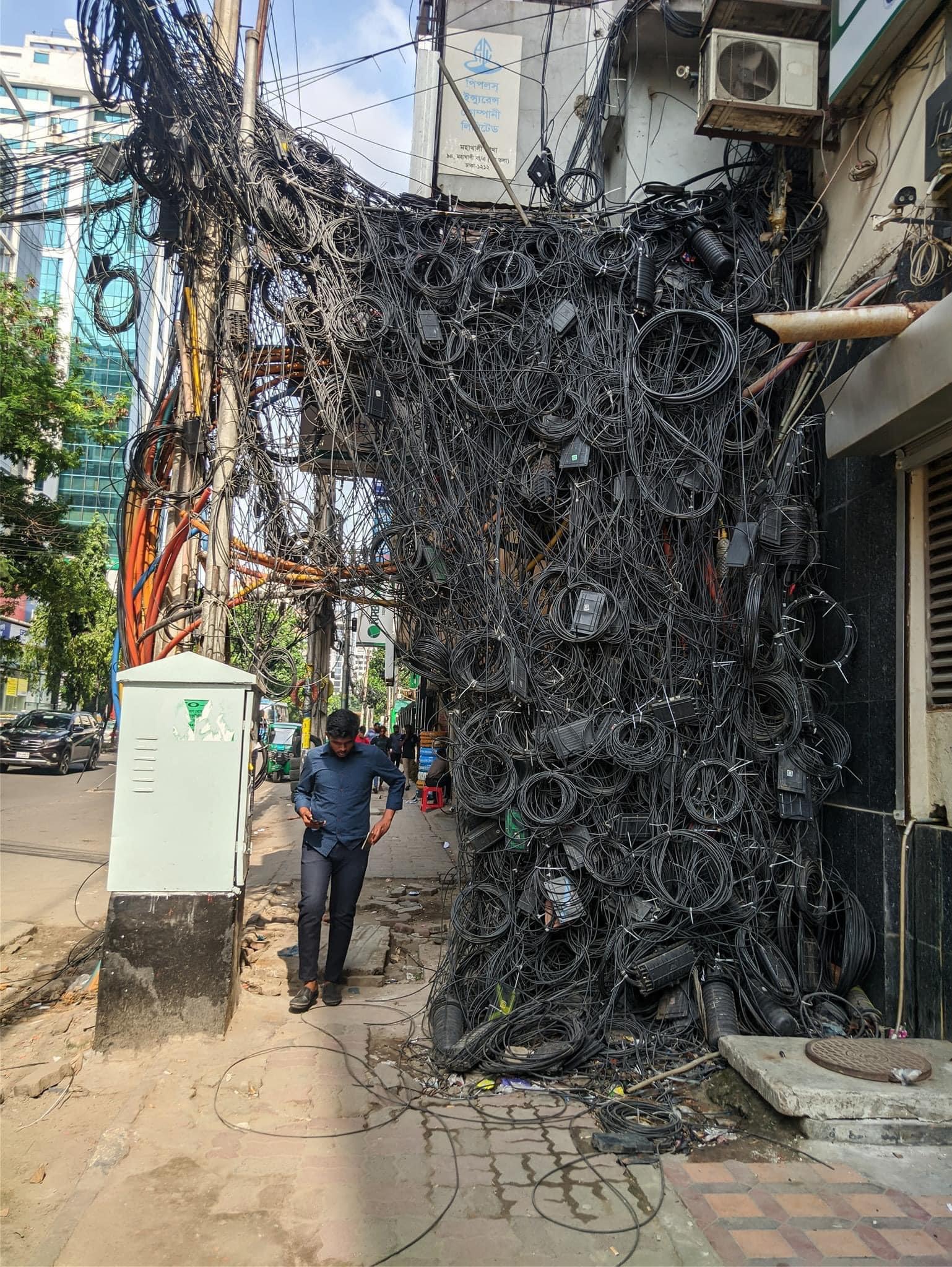

A quick google finds mentions of alarming death increases in Bangladesh, unsurprising when you see pictures.

No sir. The accident took place only 2 days ago. I don't know if any investigation is going on. :(
Looking at the pictures of the infrastructure it seems unlikely they would investigate anything?, what would an investigation achieve? - the high numbers of deaths are widely reported all across the internet.
