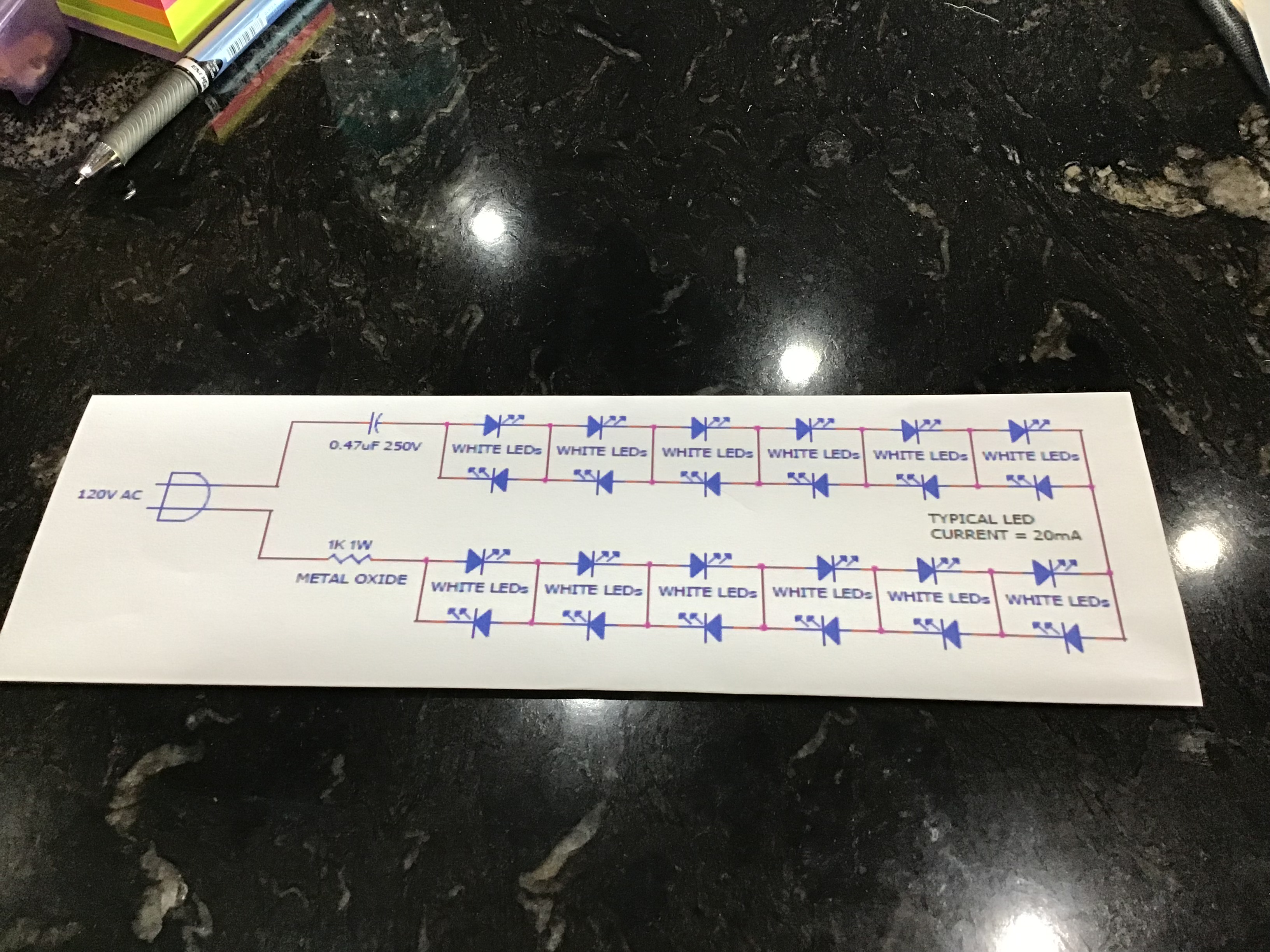

THX for your response. You confirm, more or less, what I expected as a reply. It does, however, raise more questions in my mind. The supply voltage for this LED panel is 120VAC. You mention a driver circuit for the LEDs. Do these LEDs only function on low voltage DC? Based on what I see on the circuit board there is no provision for voltage conversion. I may be wrong??? 120VAC is applied as shown in pic. Also, I researched the additional circuit included below. Basically, I’m confused with what see on the circuit board I removed from the light Assy. THX for your attention. Doug

With reference to your schematic, think what happens on each of the AC cycles. When the top pin is positive then the outer LEDs will light, when negative the inner will light. Are you sure there's only 12 in each series string?
An individual LED will only light with a low voltage and the current in one direction. For white LEDs the voltage is about 3 V, but it's the current that should be controlled, not the voltage. LEDs should not be connected to a large reverse voltage or they will be damaged. If they are connected to a forward voltage that is mor than their normal voltage, a large current will flow and they will burn out.
The circuit you show has a capacitor in series. Each time the mains goes positive, it will charge up on way, and it will charge the other way when the mains goes negative. Because the mains is a smooth waveform, the voltage only rises or falls relatively slowly, taking 8.33 ms to go from fully positive to fully negative or vice versa, and there are no sudden changes, so the current to charge or discharge the capacitor is small. The size of the capacitor and the frequency and voltage of the mains are what limit the current.
It's a bit like a tidal estuary filling up and emptying each tide. The flow of water in and out of the mouth of the estuary depends on how high the tides are, and how often, and the area of the estuary.
The design is based on a certain mains voltage and frequency, so 120 V and 60 Hz in the USA, which won't change much, so the size of the capacitor can be chosen to give the required LED current. The LEDs are supplied from the mains without there being any actual voltage conversion. The overall LED voltage, probably around 36 V in the case of your circuit, it too small to effect the current much.
The 1 kOhm resistor is to limit the current at turn on, when the voltage can change quickly. Without the resistor the current would be very large for a few microseconds, which could do a lot of damage.
I don't think that the LEDs in your first picture used that circuit exactly, because the panel is marked with a "+" and a "-" sign. It could be that it is a similar circuit, with a bridge rectifier, in which case the current will still be controlled by a capacitor. However it could also be a completely different design of circuit.
THX for your comments, Mike. The most recent pic is just a stock pic of an LED circuit using a 120VAC source. Think in terms of my first posted pic. There are 7X10 rows in the original PCB for the light fixture. If I understand your scenario, you would need even parallel strings wired in series??? Perhaps the best solution would be suck it up, go out and buy new fixtures as required and just thank GOD for China seriously, there is room for a driver in the housing if required. Maybe more important would be can I source the LED array 70 LEDs in an area of “2”x2.75” to fit the reflector housing
