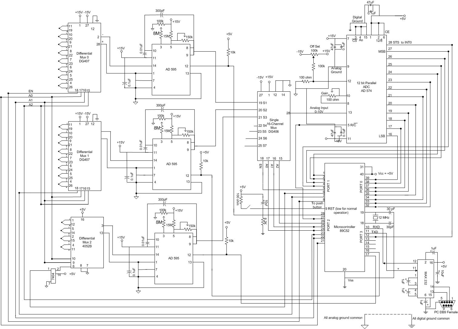

ad595 and k type Tc oscillation problems
Hi ,
I am making a data acqusation system with 20 K type thermocouples.my connection are are thmermocouple>maleconnector>female cooncteyor>sheldedwire of 15-20 cm >wire end soldered on pcb>muxdg407>ad595cq>muxDG406>adc ad574>89C52>pc .
I have got the prolem of fluctions/oscillations.when only one thermocouple is connected i get small data varation of 2-3 oC(continuous oscillations :'() but if 2 thermocouples are connected the tmep get out of control to 200 to 500 .even at room temp.also when i put my thermocouple in hot water.
I have earth the the body of thermocouple and grounded pin-1 of ad595.if i donot ground it my output goes to zero even if thermocouple body is earthed.
plz if any one can suggest a solution. or tell me what and where the probem is.Thanks :'( :-/. I spent a lot of time on this but no use i really need help thanks.....
i have tried low pass filtering but it made the system even more worse....
Hi, Janis
thanks 4 ur reply. My sechmeatic drawing is attached u can chk it. The microcontroller send adress to select mux channels one by one and then send the data value of all TC's to pc serially.
If i directely connect a TC to ad595 the noise problem is solved by connecting 8 TC to one ad595 through a mux is creating problem . I have used shelded thermocouple wire and green colour K type connectors. even then the problem is not solved. if u have any suggestions.Thanks

Hi, ayeshasaftain.
Thanks, for reply.
I read some additional info. May be you already reading it, too. Maybe some researching experiments will be helpful for you ?
Some moments about multiplexed thermocouples Figure 11.from this AN about :
- all interconnects,
- enable input connection to + 5 volts, you are switching 3 enable inputs, 3 groups with sensors
- unused multiplexer inputs
And how with average temperature measuring Figure 10. from this AN ?
Regards, Janis
Hi, thanks a lot 4 ur replies.
Andrew the IC ad595 I am using already includes cold junction compensation. and I am using both class1 and class2 device. and connected the thermocouple via shielded cable to the pc. don't the shelded cable of TC work as compensatrion cable.
Thanks Janis I have read the application notes but I donot know what type of isothermal block they are using .I have searched a lot on net but didn't find any such kind of block. if u have any idea?.
I can't afford oscilation of more than +-1 degree. when only one TC is connected situation is fine but connecting two or more make situation worse.
Andrew do i have to earth both class1 and class2 devices or there is some rule.
Thanks for ur time.
Hi.
Some links for info :
Capgo - Thermocouple Theory
class 1 and class 2 devices means only tolerance of sensors, I think.
find some more info about isothermal block
You have 3 mux - 3 groups of sensors.
1. connecting sensors only to one mux
2. connecting sensors only one to every mux
but as you read from AN , unconnected inputs you need grounded .
