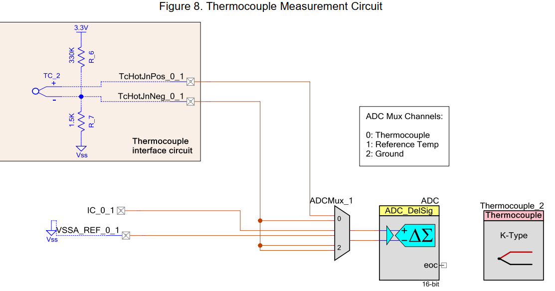

The attached might be useful. With one SOC you can do multiple thermocouple
because of DelSig accuracy (onchip Vref) and on chip muxing of connections.
Project example and ap notes attached.
Easy to add internal LCD controller to get readout.
Note this is what SOC has in it, multiple copies in most instances :
Regards, Dana.

You can solve this issue lot easier.Use 4051 multiplexer to switch between TCs +ves Tc -ves connect to Room temp ref points.Output of 4051 goes to op07 amp circuit and connects to adc input of a microcontroller.You have to read the ADC values and linearise to get your readings.If you want a full circuit diagram and code let me know.
Also TCs can be connected via compensating cables as TC wires are expensive ,and they look like copper wires.Check that out also.I have used PIC in my product.Also you can check on our products at [advertising removed - moderator]
