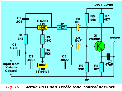

ak
You can read the details at this URL:
https://www.learningelectronics.net/VA3AVR/tutorial/xtor/xtor5/xtor5.html
