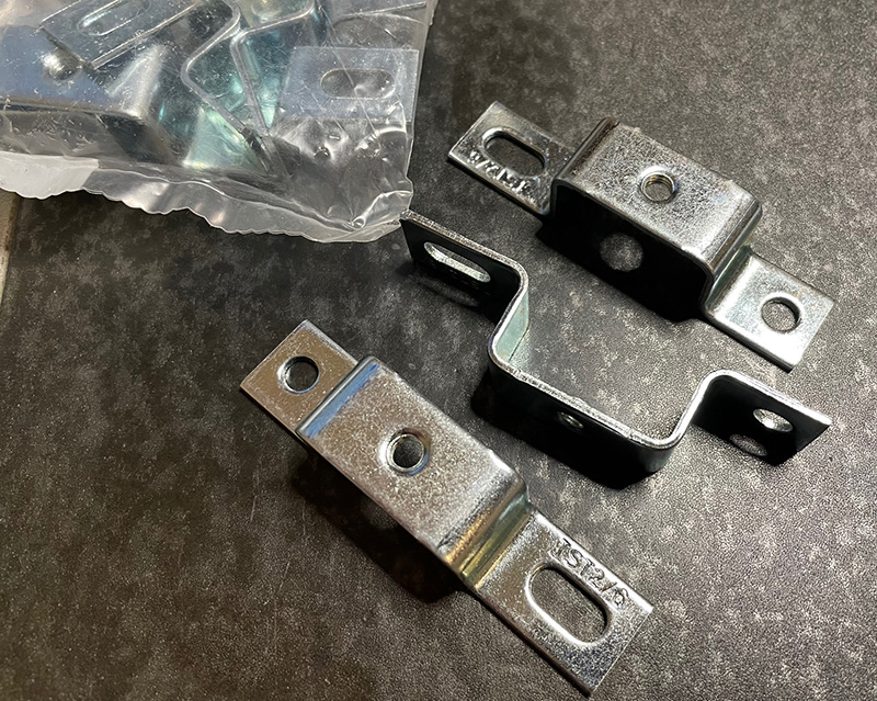

You could use "top hat brackets" to lift the DIN rail, they may be more stable than studding.
They are available for that exact purpose, but you can equally just make them from cut & bent metal strip.
These are rather shallow ones, but you can get (or make) them to whatever height you need.
That’s a great idea. I’m not necessarily looking for perfect. I just need something workable and maybe looks a little professional, I think between these posts I should be able to throw together something.
