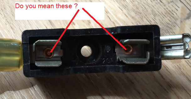

Ok now another question, how can I remove the metal casing for the fuse holder without damaging it? There doesn’t appear to be screws just the two small bolt-like things on the bottom. Disclaimer I am using the fuse holder to tap the primary.

Do you mean the copper coloured things indicated below?
If so, they are rivets, the only way to get them out is to drill them.
Carefully.
Carefully.
Yes those. Thanks I got em now. I don't know what I was thinking, I just needed to chip away at the sides and corners of the black enclosure.
