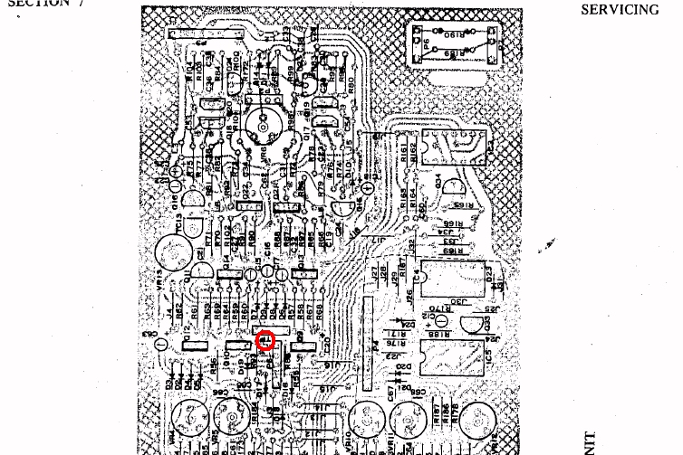

Ok, I think "TP" means "Test Points". I can't find anything labeled but there are two buttons of solder on the bottom of the V PCB between the 8 pin (7 used) connector from the PS and the edge of the PCB with no component or jumper.
Can anyone confirm?

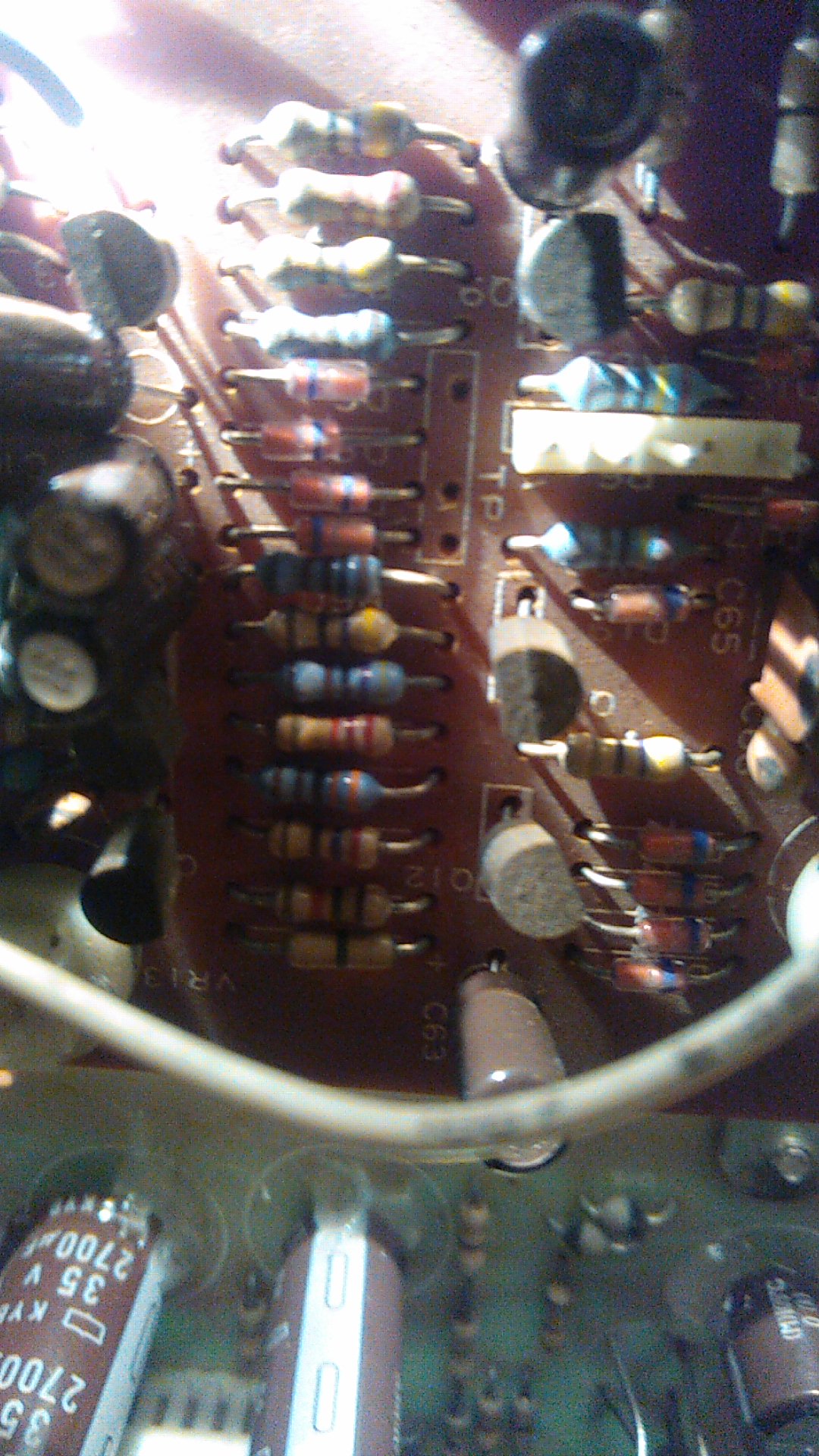

I found it on the board. TP next to a rectangle with three holes (ports) and line dashes pointing to one of the holes and a pin on an adjacent connector.
I guess that means to jumper the center hole and the first (nearest) pin on that connector?

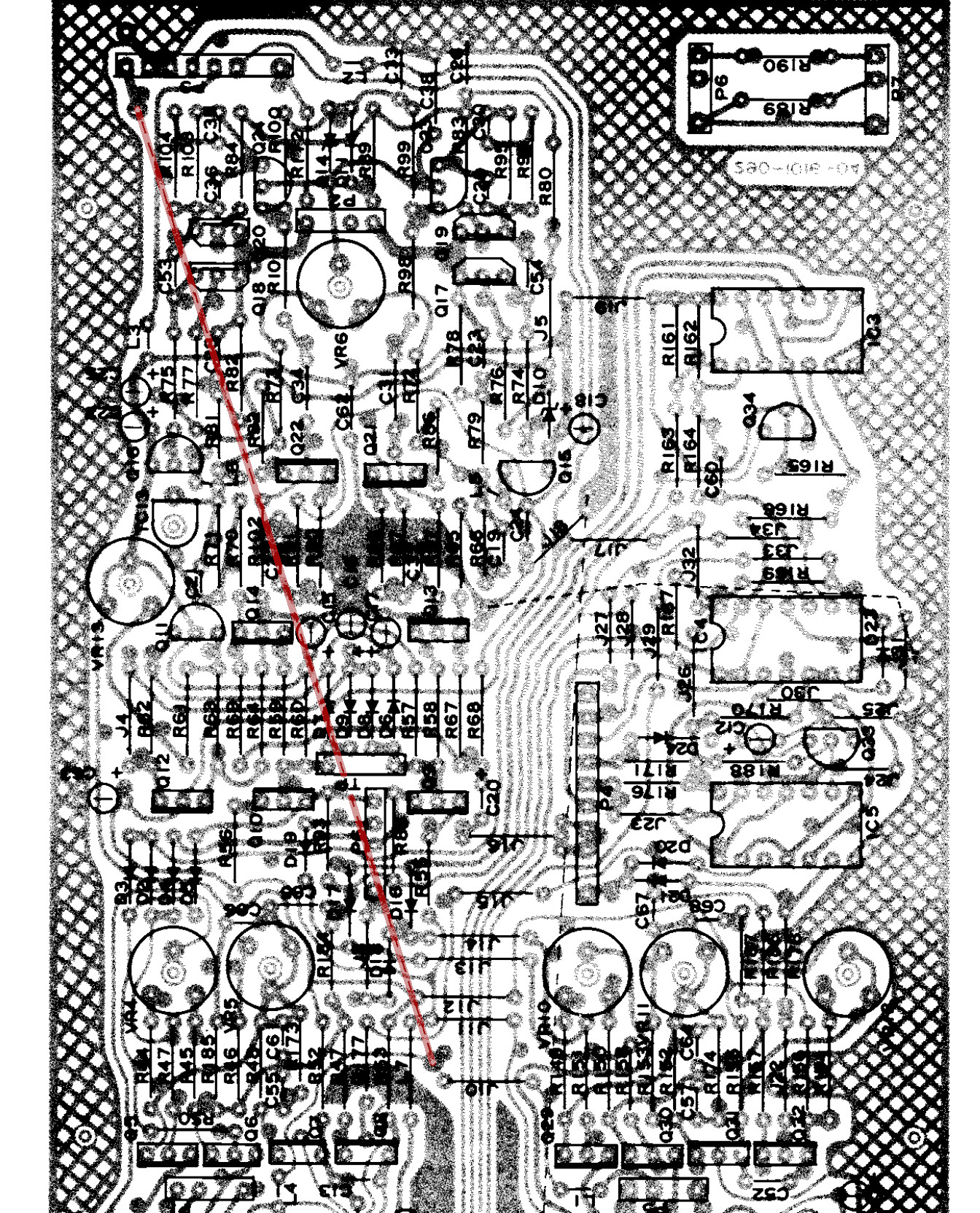

That dashed line actually extends past the connector over to a white wire soldered to the board and the other way to either to a capacitor or maybe all the way over to the other end of that wire which is also connected to the board,
I wonder if that wire is already shorting the TP or is it just the two holes in the rectangle that are closest together?
I found the dashed line on the layout as well, it does extend between the two ends of a white wire.
So, is that wire the jumper between the test points, or just indicating a jumper?
Which terminals should I short?

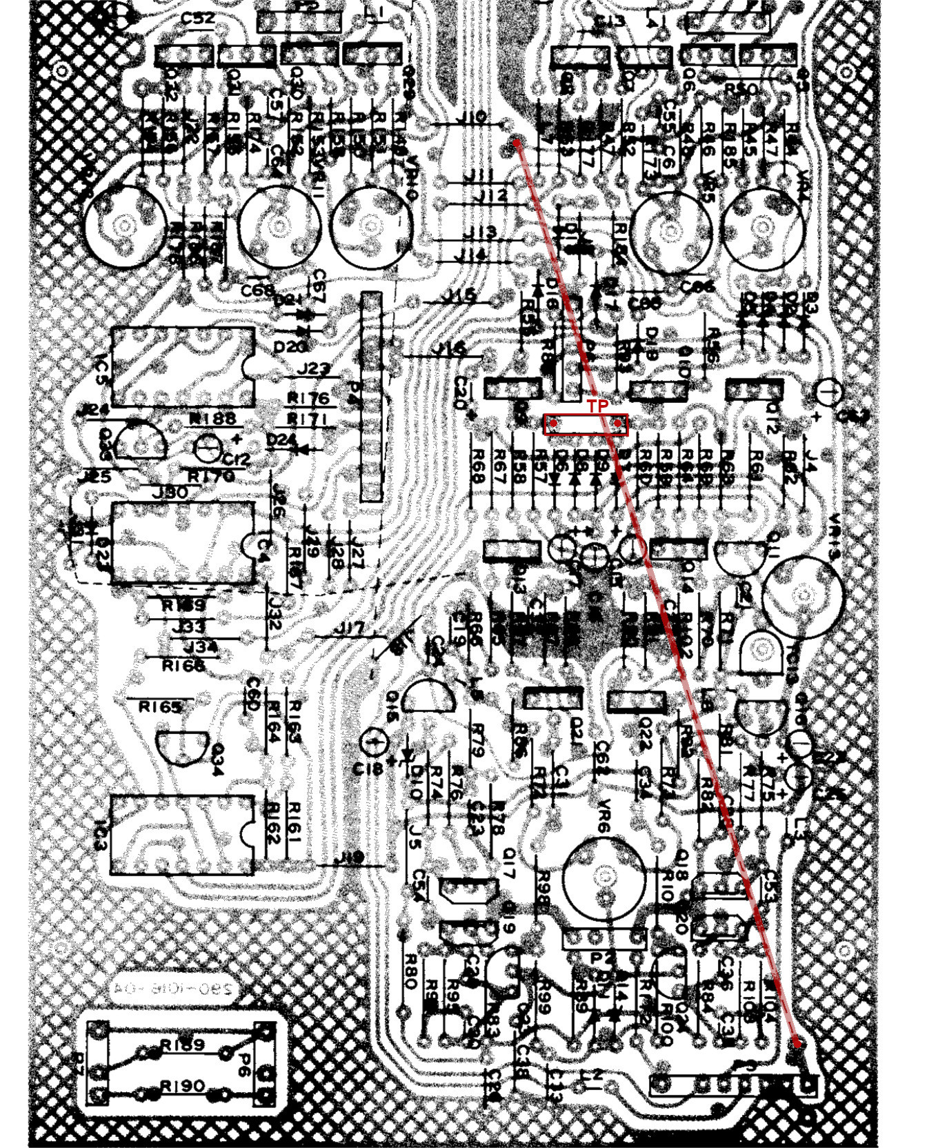

When I look closer at the layout, it only shows the two outer holes within the box while there is a third hole within the box on the actual board. Now I think it's either those two outer holes within the box or the white wire connected at each end of the dashed line.
Does the "TP" signify the box or the dashed line?
