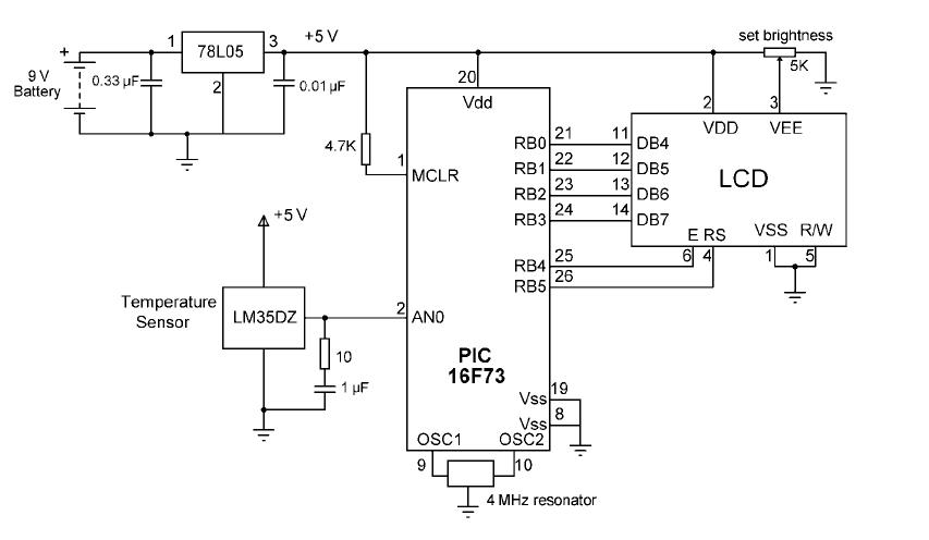

Do you have a circuit diagram you could post.?
If you use a 2.5V ref, you must alter the program to make RA3 a Vref pin...
I will post the circuit diagram, and you can analyze it and make changes that will need to be made in
program and the hardware, ok? (The entire program I posted earlier)
Thank you again!
Cabral

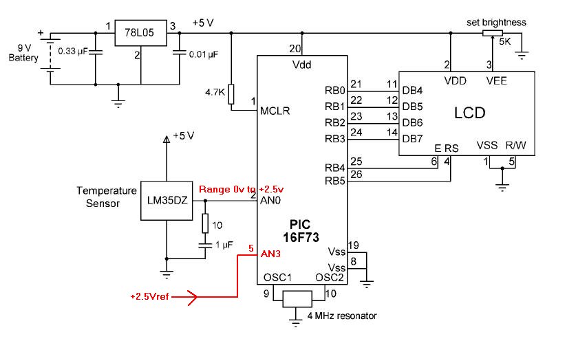

Look at this image.
Change ADCON1 configuration to set AN3 as a +Vref pin

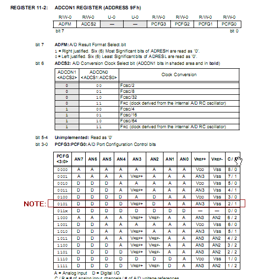

your code.
ADCON1= %10001110
change to
ADCON1= %10000101; AD3 = +Vref
Look at this image.

What voltage do have connected to AN3, it should be +2.5V, thats the reference voltage that you have to apply to the AN3 pin.
You are not setiing the ADCON1 correctly!!!!!
ADCON1 = 0 ' Make AN0 to AN4 as analog inputs,
Its not correct if you want to use a external +2.5V ref.
Please post a circuit diagram showing how you have the analog pins connected.

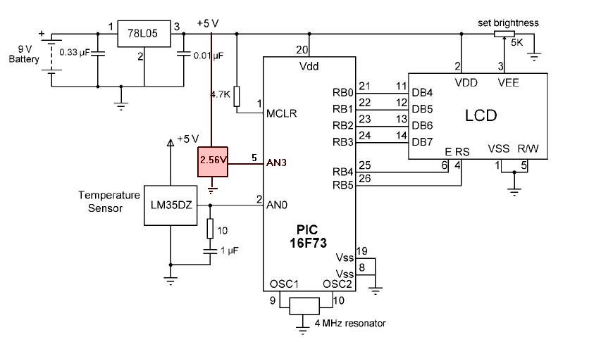

Ericgibbs,
I put a reference of 2.56 volts on pin 5 (AN3) as you guided me in the drawing in
Annex, and the software I replace the ADCON1 = 0
by ADCON1= %10000101
as you guided me ...
Cabral

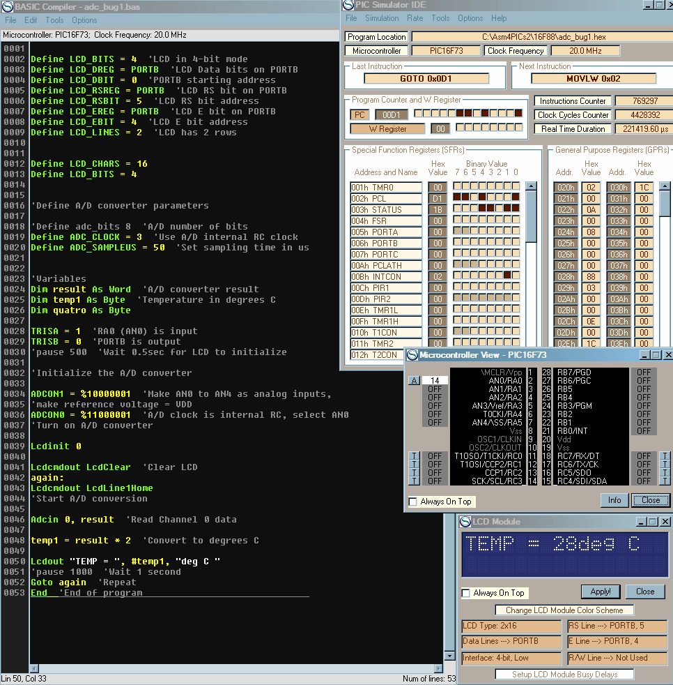

This is your program, I have had to modify it so that it will run in the Oshonsoft simulator.
Its uses the same pins as your circuit, with ADCON1 set and it works OK.
Look at this image.:)
Ericgibbs,
It worked! Now worked! :D:D
I used ADCON1 = 10000101% as you had suggested
and 2.56 V on pin 5 (AN3) and not more variable Temp1 multiply by two (res = temp1 * 2) and
worked very well!
Thank you very much for your help and patience friend!
Big hug,
Cabral
