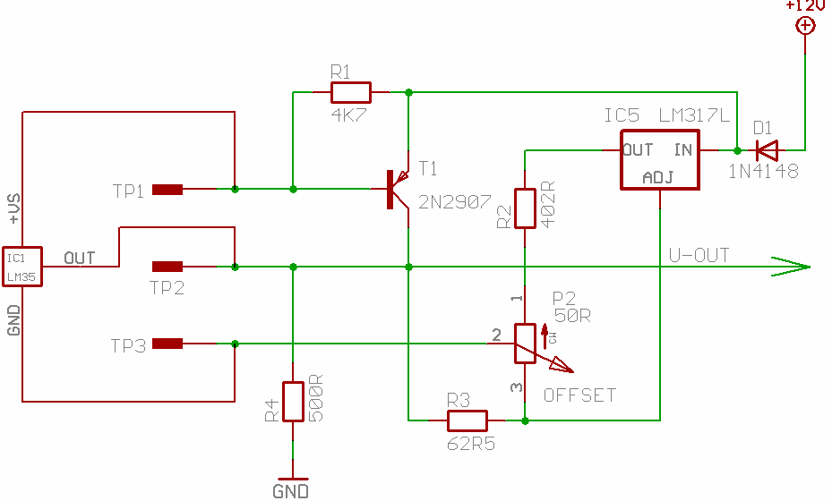

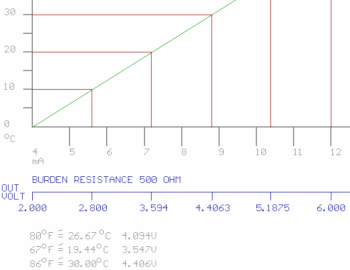

Hi civictypeR,
there is another easy approach to use the LM35 for an MCU circuit. Use a current source from 4 to 20mA.
Depending on the burden resistance (500Ω) the output will be 2 to 10V for 0 to 100deg/C or 1 to 5V using 250Ω.
Here is an example as used in the data sheet.
Boncuk
