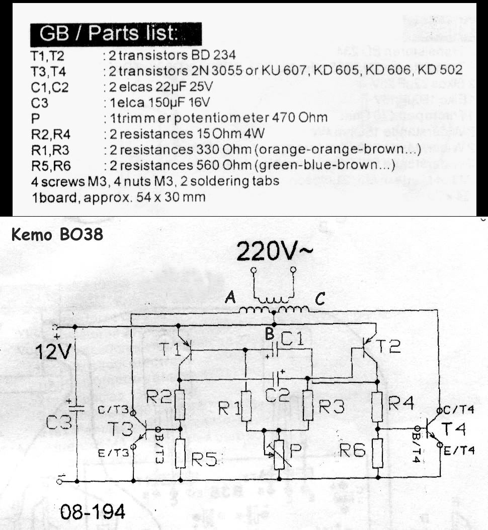

schematic....
I'm posting the schematic and parts list in the hope that someone might offer me some advice.
As mentioned in the previous post I'm currently using a 12-0-12/117 volt transformer (2 amp), but only getting 64 volts out (analog meter) or 76 (digital meter). The output is a very clean looking square wave.
Would someone explain why the two voltage readings are different, and which one I should be concerned about relative to the synchronous motors this power supply will drive?
I need to replace this transformer with another in order to get the output above 100 volts, but I'm a bit unsure about how to select the proper transformer. My choices are:
20-0-20/230 volts, or 18-0-18/230 volts. (This is all I can find in Australia)
My confusion comes as a result of measuring voltages between the points A,B,C on the schematic:
I'm using a digital voltmeter set to "AC" but I get 2 different readings depending on the polarity of the probes - thus I'm not sure what the true AC voltage is across the secondaries of the transformer. I get the following:
A to B = 11.0
B to A = 7.5
B to C = 10.7
C to B = 8.2
My guess is that I should consider the lower voltages as being the "true" ac voltage driving the transformer based on the following calculation: 8.2/12 x 117 volts = 79 volts which is very close to the measured 76 vots at output.
If this is correct then using the 18-0-18 transformer should give me 104 volts.
I'd appreciate any comments about this reasoning (or more probable lack of reasoning!).
