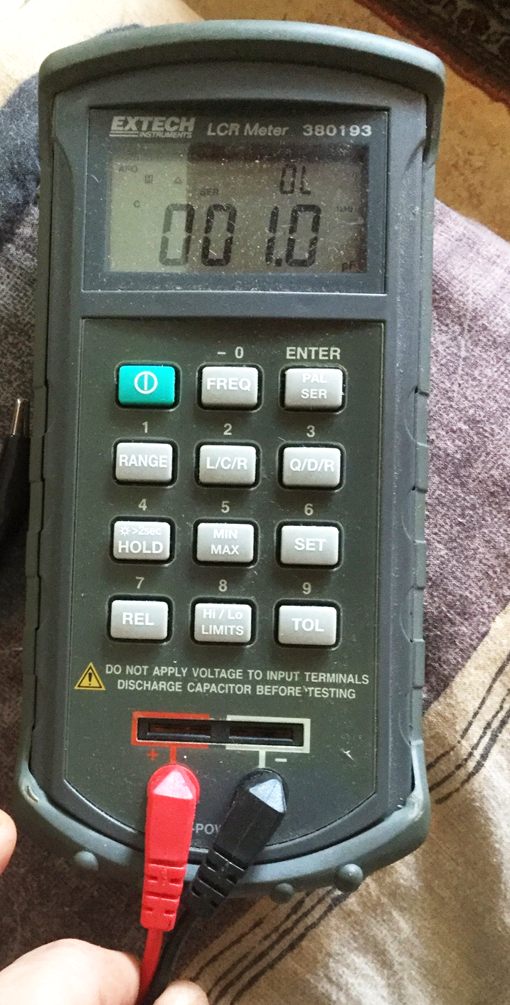

Here is my LCR meter and I am calibrating my finger pressure to get 1.0 pF on a pair of measurement wires after null calibration.
THis is useful when you want to tune XTAL clocks with your fingers and find out why the frequency is too high by x ppm.
But I have my fingers calibrated from 10kOhm to 10MOhm and 1pf to 50 nF.
It's very handy to debug designs with your LCR calibrated fingers.
Note in order to measure ESR with a Cap with external bias , it MUST be coupled with a larger series cap with a lower negligible ESR
THis tester does not have this. But it can be done externally. And yes all caps except in general plastic and COG ceramic have a sensitivity of dC/dVdc which is the cause of AC coupled audio distortion that "analog guru" and others have reported accurately.
