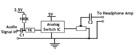

OK heres the test circuit. (showing just 1 channel)
C1 and C2 are the caps im talking about.
The POT is 50K

Many analog switch ICs have a pretty high distortion when they use only 5V for a supply voltage. A CD4016 is not even spec'd with a supply voltage as low as only 5V.
A CD4066 has much lower distortion than a CD4016 but it is also not spec'd when its supply is as low as only 5V.
Your C1 feeds 33.8k if the input impedance of the amplifier is high. Then a 1.2uF capacitor will have a response that is flat down to 20Hz.
What are you using as an audio source?
I think that there will probably be more sources of distortion in the audio source and in the analogue switch than the electrolytic capacitor.
I think your reason for preferring the ceramic to the electrolytic is purely physiological. Somewhere you heard that electrolytic are worst than ceramics and believed it to be true so it's no surprise your experiment backs up this theory. Constructing an experiment to prove what you think is true probably won't prove it otherwise, especially if the testing is purely subjective as it is in this case.
I would suggest a blind test, try encasing both of the capacitors in film cases or something that will make them both look the same. Test them both randomly, decide which is the best, then reveil which is the electrolytic and which is the ceramic. You might be very surprised.
One article measured the distortion from coupling capacitors. Ceramic capacitors that were taped in a row by the manufacturer had a range of distortion that was 10 times.
Rod Elliot figures that distortion from "bad" capacitors is lower than 100dB below the music level. So low that the distortion cannot be heard.
Yeah the headphone amp is class A and has a high input impedance.
Thanks! Looks like I can go down a bit in the value of my coupling caps, thats really helpful.
