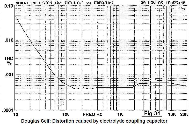

1) Douglas Self designed an audio power amplifier that has distortion of only 0.0005% at low and mid frequencies. He wrote a tutorial about reducing distortion. He has a graph of the sharp rise in distortion caused by an electrolytic coupling capacitor.

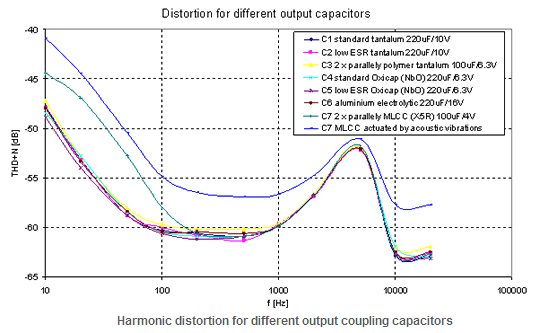

2)AVX tested an "ordinary" tantalum coupling capacitor which has high distortion and tested their best tantalum capacitor that has the same amount of distortion as an electrolytic one. They do not show the zero distortion of a film capacitor.

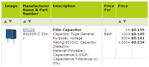

My metalized poly film capacitors are not large and are not expensive. The EPCOS brand of a 330nF/5%/63V one costs less than 15 cents US at Newark and is about 6mm wide (5mm leads spacing), 5mm high and 2mm thick.

Well, I did it anyway, just for fun:
I used a HP8903B audio analyzer and connected a single pole passive RC highpass filter on the output of the audio generator running at 5Vrms @ 160Hz. R was 600Ω, C was 1µF and the distortion analyzer was connected across the resistor. The results are below:
Direct connection with 600Ω load resistor only (No capacitor) = 0.002%
Distortion with no DC bias on the capacitor under test:
Metal film = 0.002%
Electrolytic = 0.016%
Dip Tantalum = 0.425%
Ancient axial Tantalum = 0.028%
SMD Ceramic = 0.420%
Distortion with 9V DC bias on the capacitor under test:
Metal film = 0.0035%
Electrolytic = 0.029%
Tantalum Dip = 0.190%
Ancient axial Tantalum = 0.022%
SMD Ceramic = 0.609%
The only result that puzzled me was the Ancient axial Tantalum until I googled it and saw that it was still listed on the NASA site. :D
