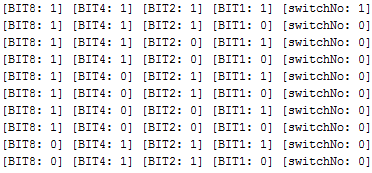

Just did a test using the Or operator as suggested from 0-9, +5V to Pin 7 ULN2003, see attached:
Cheers

I have to admit trying to understand this is beyond my capability at this stage.
It may be better if I just return to using voltage references as the set points & see what error exists & then try to compensate for it?
I don't know?
Cheers
Post your code again. Thanks. See next post.
It should look like:
if ( val_BCDpin1 == 0) { switchNo = switchNo + 1; }
if ( val_BCDpin2 == 0) { switchNo = switchNo + 2; }
if ( val_BCDpin4 == 0) { switchNo = switchNo + 4; }
if ( val_BCDpin8 == 0) { switchNo = switchNo + 8; }
or
if ( val_BCDpin1 == 0) { switchNo = switchNo | 1; }
if ( val_BCDpin2 == 0) { switchNo = switchNo | 2; }
if ( val_BCDpin4 == 0) { switchNo = switchNo | 4; }
if ( val_BCDpin8 == 0) { switchNo = switchNo | 8; }
They should both give the identical result.
switchNo is an integer - Not good! This means that NOT will give very wierd results. In any event, the bitwise NOT operator is apparently "~" and not the "!" :oops: Logical OR wasn't right either.
It has to be an "unsigned int" for NOT to work correctly.
