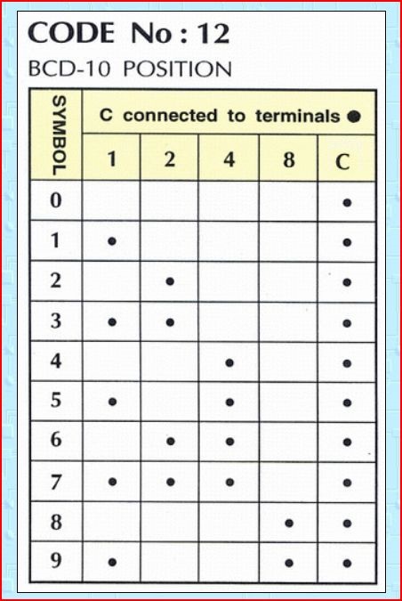

BCD: No datasheet. You really need to figure out how they are wired. 8-4-2-1 weighting does suggest BCD, Trust, but verify.

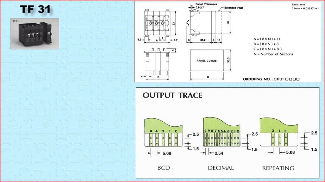

I finally found some info on the BCD switches, see Attached.
I was going to try to read the switches with the Arduino later today to see how I go with it, should be a good learning exercise.

It's taken some time DUH! but now I can see how the SN74LS138J chip works, not understanding the Datasheet & the truth table before made it difficult but when you work it out it does seem easier.
I understand the BCD switches as well.

That's what kind of BCD switch I think you have, but there are so many OTHER options. Earlier, I showed some datasheets from DigiKey. If your lucky, that's what the pins would be labeled too.
To read the BCD value, you need to have pullups, either physical or enabled on the port. 10K should be sufficient. Each bit should have a diode with the band facing AWAY from the port and to the respective pin (8,4,2,1) on the switch. The common of the switch would be connected to ground.
You want the order 8,4,2,1 to match the endian of the processsor. Big and little endian. Little endian is when the rightmost bit has the value of 1. Because of the action of the pull-ups, you will actually read the complement. So, a 1 will be 8+4+2 or 14. If it is shifted, the port will read as one of these 14+16, 14+32, 14+64, 14+128.

I connected the BCD switch Common to Ground as first suggested to see if I could get things to work, I used the INTERNAL pull up resistors in the Arduino & seem to have things working.
I noticed that the output is inverted with the connections this way but all is good so far.

So, take the output of one of the ULN2003 channels and connect it to the common pin of the BCD switch after removing the connection to ground.
The ULN2003 chip is a bit wierd if you never used one. Just think of it as 7 transistors with an integral base resistor. It does not have to be powered by a +V supply. The COM is just where all of the flyback diodes come together and that pin isn't needed in this application.
So, to read this BCD switch now, you have to SELECT it with a high on the corresponding input,
Your going to have like 5 or 6 diodes commoned at the processor's 4 bit input. The free end of the diode will go to the BCD switch (1,2,4,8).
Then, the common terminal of the BCD switch will go to the output of one of the ULN2003's. So, assuming it;s done intellegently, you;ll have to provide a 10000, 01000, 00100, and a 00010 and 00001 to read each of 5 switches. 00000 is no switch selected.
We can reduce 5 bits to 3 if necessary. And up to 7 switches to 3 bits. (0-7) and 4 bits could address up to 15 switches with some external logic.
