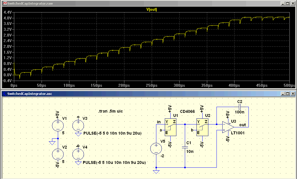

I've posted another sim over at AAC.
Perhaps this sim will help inform the discussion:
It is clear from the plot that since C2 = 10 x C1 in this example, it takes 10 steps (10 x the pulse-period) for C2 to charge up to the same voltage that is applied to C1. The output can be deduced as V(out) = -V(in) * (C1/C2) * time/pulse-period.

and what i had found with the simulations i did was that the switched capacitor integrator had a function:
H(w)=K*(C1/C2)*w0/w, {with K a fixed gain}
and that tells me that the 'new' formula is either wrong or involves some other assumptions or something else we dont know about yet.

I finished my first simulation in PSpice software.... I simulated both Continuous and the SC integrators (Please keep in mind that here we are looking for the relationship between the continuous interrogator and the SC one --I'll explain today when I'll add the Schematic and the waveforms of my simulation--)....
The simulation showed to me that the gain of SC integrator I simulated with respect to the Continuous one is "(C2/(C1+C2)" at least for when the gain of the continuous one is 1.

Wizard, now that you have simulated the two circuits i would like to see two things:
1. The two circuits and all component values.
2. The two simulation waveforms, one from each circuit at least.
3. How you are reasoning that the two are the same, or are related by that formula in the thread.
