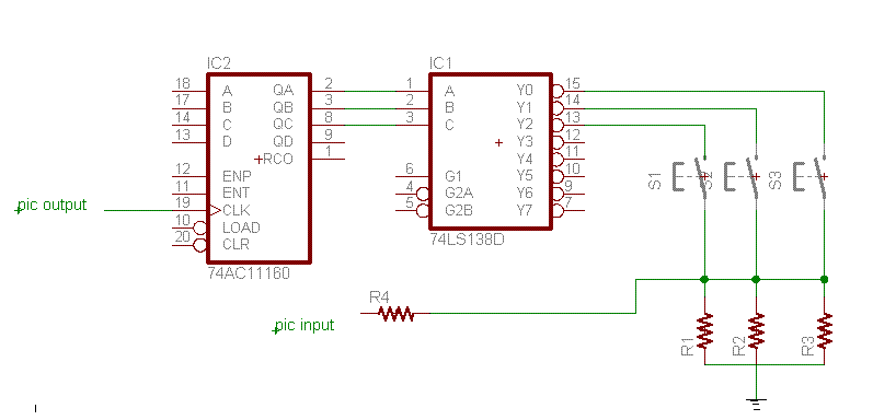

the circuit listed below is only to show the LOGIG behind switch multiplexing . the parts listed such as 74AC11160 may NOT work as described .. it was my intention to show only the logic connections required.. your choice of specific chips may vary..ie an LS160 will work..
also all connections to get the 138 to work properly are not described..
With that said i believe the circuit will work..

It might have helped if you had posted it in a readable format?, only a small number of people can probably read the file (I'm not one of them!). You should use popular graphics formats, and not obscure proprietary formats which require people to have the same package as you. For a diagram, GIF is an excellent choice, as it gives full quality and excellent compression.

sorry , i thought every one on here had eagle layout SW
EDIT : disclaimer still applies..

What's the purpose of 3 paralell resistors?
EDIT: And I think this is just too complicated to save 1 PIN (2 IC's !!!)

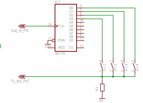

I think 4017 would serve well!
lol , good point i suppose only one is really needed..
EDIT: you dont see the usefullness because i didnt draw in more switches..
ie ONE 3X8 decoder can multiplex 8 different switches..

congradulations Jay we just developed a switch multiplexing scheme for the pic , which can input any number of switch inputs and combinations of them...
because in one pass 0 to 9 of the counter if two switches are held down , the pic can determine that too !!

Yeah ,but say you wanted to add 9 switches to your project and you only had one input and one optput left..
a single 4017 seems like a viable solution
