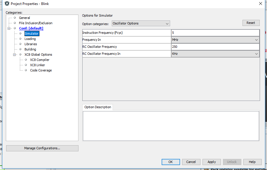

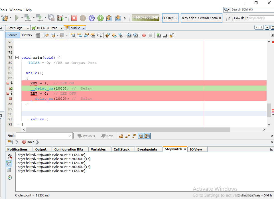

I am not sure but I think simulator show the correct delay time ?
When I ran code in first post, LED is flashing but I don't know the exact time and frequency ? That's why I want to know delay time
Are you building it?, or using the simulator?.
As I said earlier, it will be blindingly obvious with hardware that it's right or not. But as Ian pointed out that 20MHz isn't even an option using the internal oscillator, then it's not going to correct.
If you are using the MPLABX ide then the delay is not real time... You can say Mississipi a million times..
Simulators DO NOT MODEL the xtal... Protues does a "sort of " precalculation of Tcycle and gives reasonable results.. MPLAB just keeps clocking so if a tcycle is 1ms then 50000 will be 50 seconds.. best to run it on your dev board.. pickit 3 is simple to use as the debugger.. in your project properties select pickit3 instead of mplab sim...

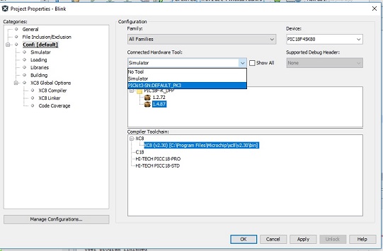

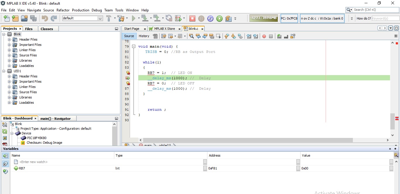

When I set break point at two lines
RB7 = 1; // LED ON
__delay_ms(1000); // Delay
RB7 should be high and LED should be turn ON but it doesn't happen ?

How do you know RB7 is not high? Is it an analogue pin? If so, you need to make it digital. Are you overloading the pin with the wrong series resistor or the LED incorrect? Is RB7 a debug pin?
Edit, Ian beat me to it. BTW, I tried to download the datasheet but Microchip isn't responding. I could get one from Mouser but it seemed to be a shortened version, didn't even have the pinout!! I hope this isn't how the new datasheets are going to be.
Edit2, Phew, just found the correct datasheet and all's well.
