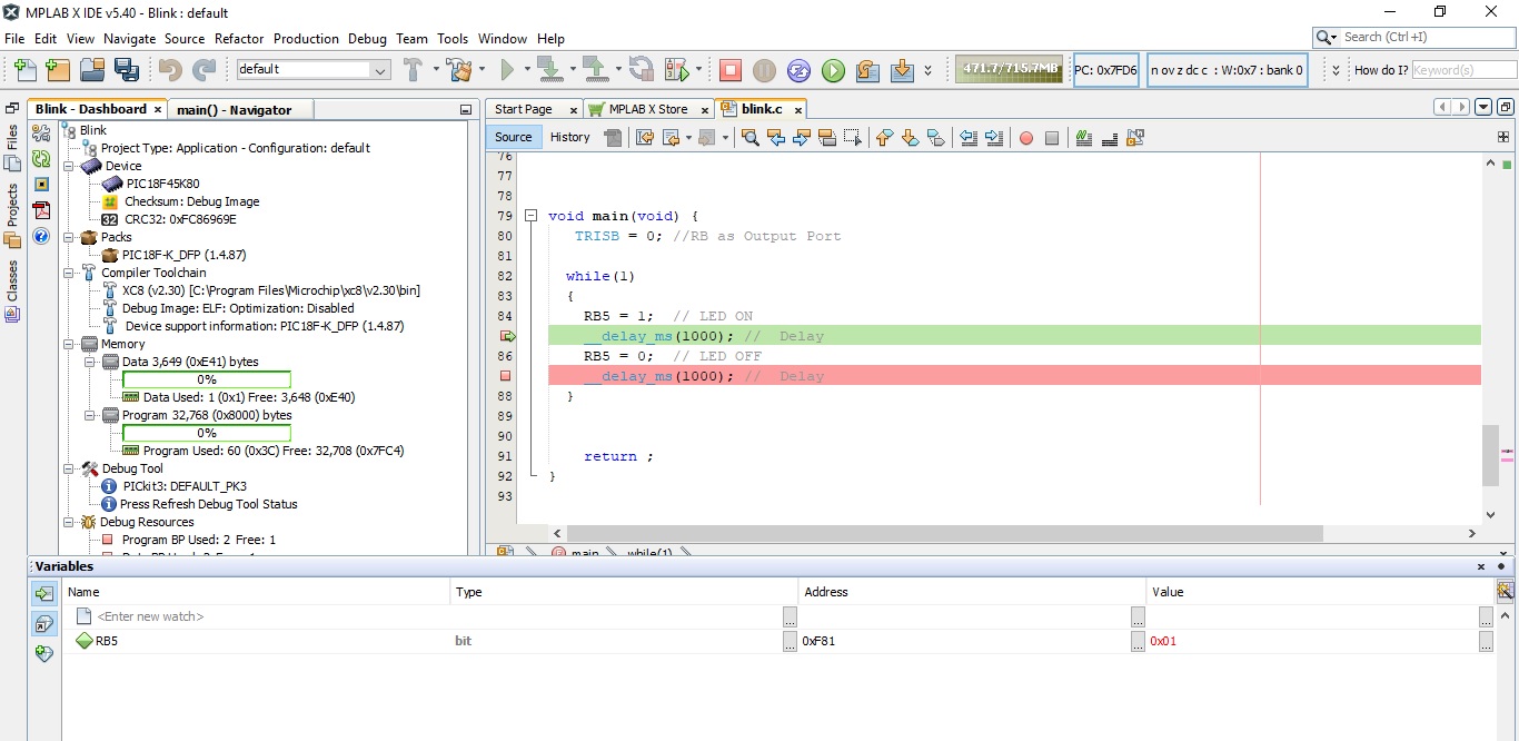

How do you know RB7 is not high? Is it an analogue pin? If so, you need to make it digital. Are you overloading the pin with the wrong series resistor or the LED incorrect? Is RB7 a debug pin?

How can it!!!!! You are using RB7 as a debug pin... You cant use RB7 when debugging, its using RB6 and RB7 to run the program..
you are correct I didn't see datasheet before that RB7 is PGD pin
I am using RB5 instead of RB7

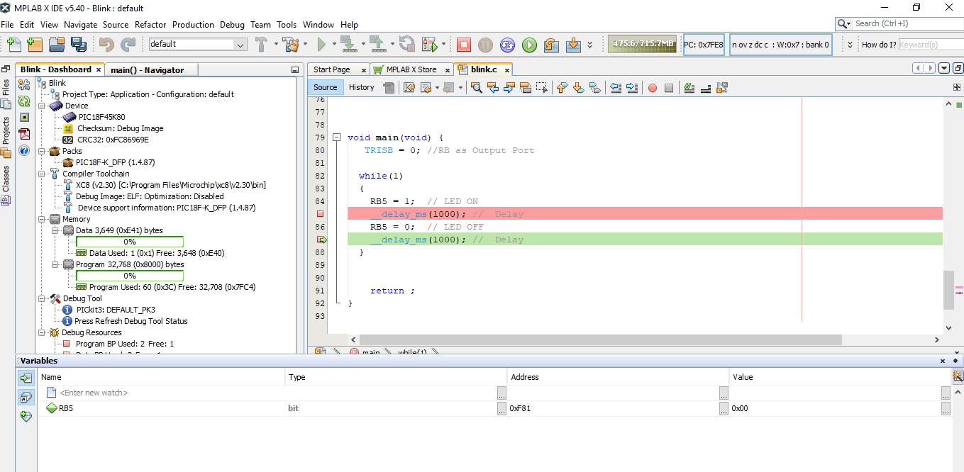

Please find the two screenshot my. goal was to understand the process of hardware debugging. I am setting break point to check pin status. I think I understood the hardware debugging process using PIC kit 3

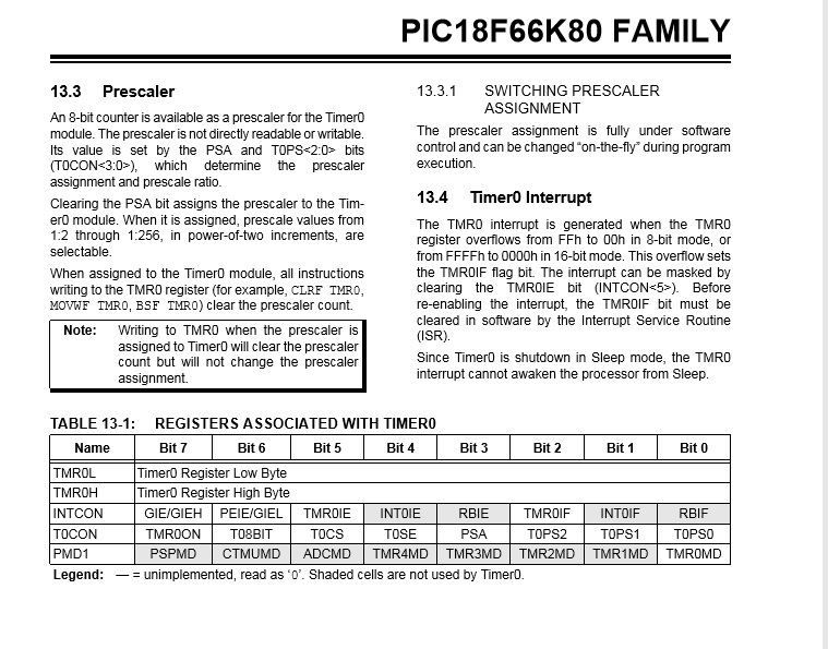

I have attached datasheet I am following
Do I need to configure following register to set timer interrupt ?
What should be value of timer register to generate interrupt at every 1 seconds ?

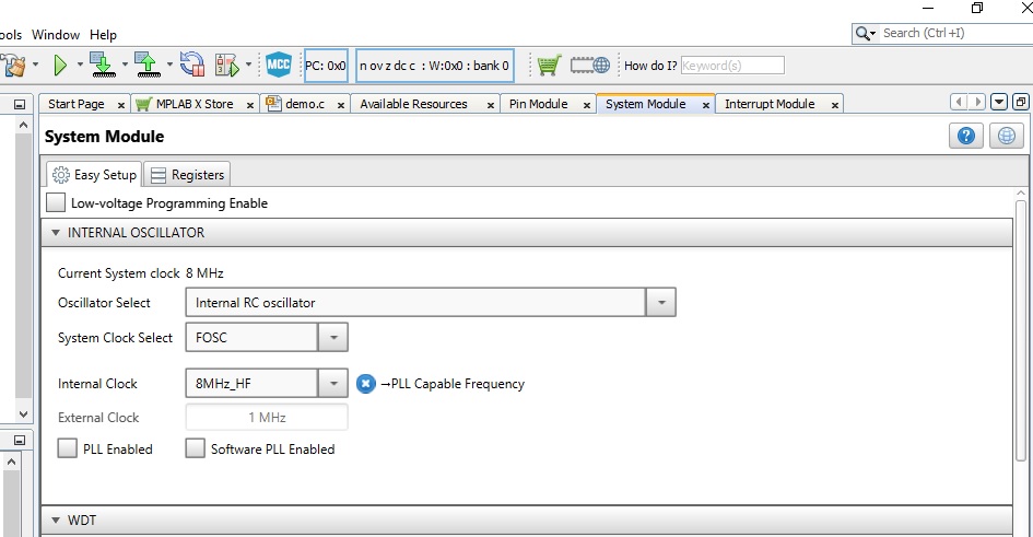

I'll repeat again - use the MCC - this allows you to easily set your clock oscillator and the various peripherals, such as the timers.
However, depending on your clock speed it's VERY unlikely you will be able to get a 1 second interrupt from TMR0.
I do it in two different ways:
1) fit an external 32KHz crystal for the timer, this allows easy 1 second interrupts and low power consumption with the PIC in sleep.
2) generate a fast interrupt (I usually use 1mS), count the interrupts in the ISR, and set a flag when the required total (1000 in my case) is reached. I use this method if I'm not using sleep.
I do this with (almost) all my projects.
