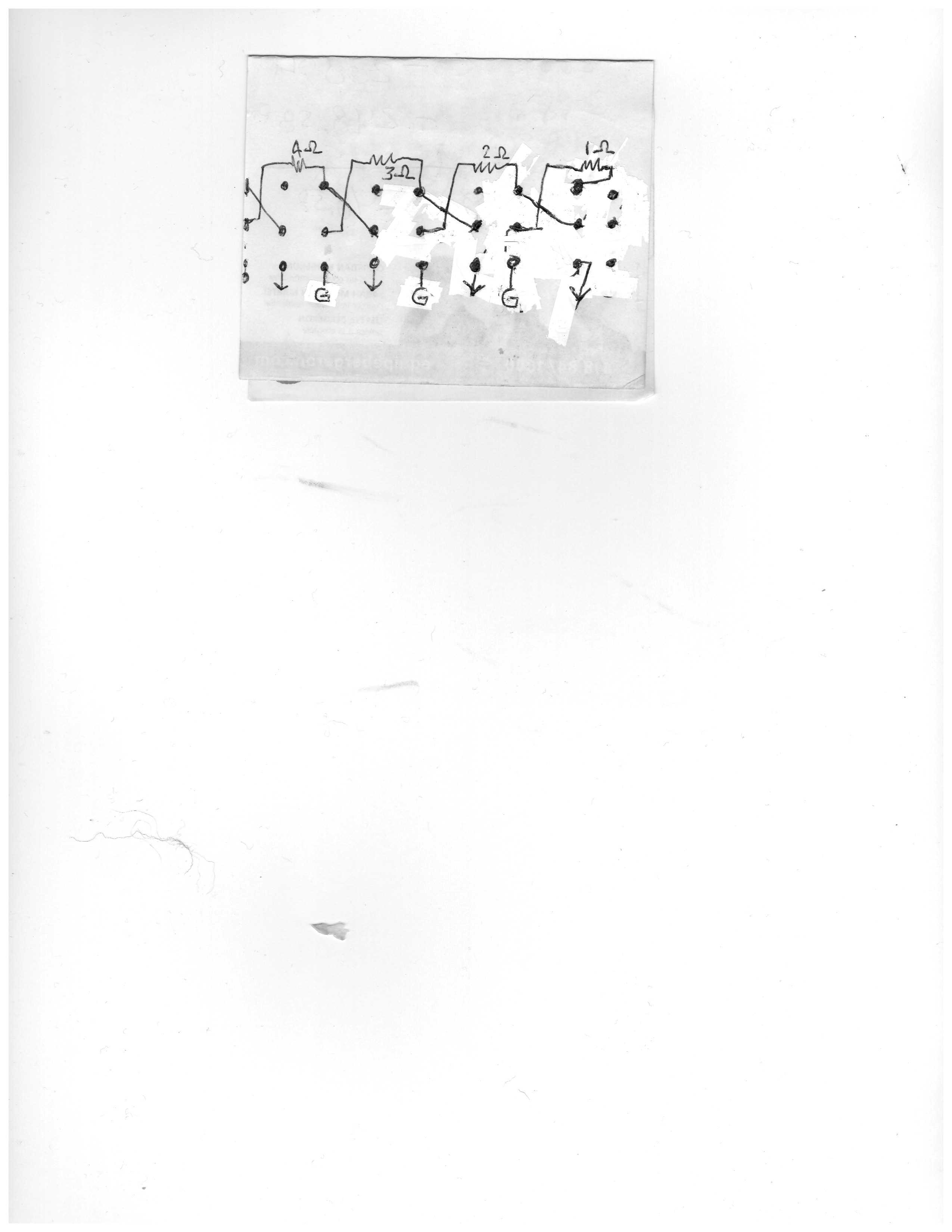

Hi. I want to build a resistor box and I need a diagram to realize this project. Example: I want to switch 10-20-30-40 ohms with 4 switch BUT if I switch the 40 and the 20 ohms, I want these in serie to get 60 ohms. I have DPDT to do that. Is it possible? Thanks for any help.

Here is the diagram I did but it won't work as I wish Note that the G and Arrow are probes input

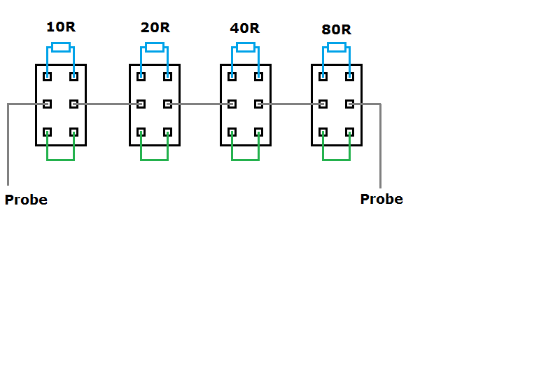

Taking the suggestions from Nigel and Pommie, the below should give what you require (+ an additional 50 Ohms)

Happy that works for you Danny, although most of the solution came from the combined input of Grossel, Nigel and Pommie.
You should thank them.
I would put the resistors across the center switch terminals, and leave the short on the pair of outer terminals. When the switch is open, the resistor is in the circuit. When the switch connects the shorted terminals, the resistor is shorted out.
