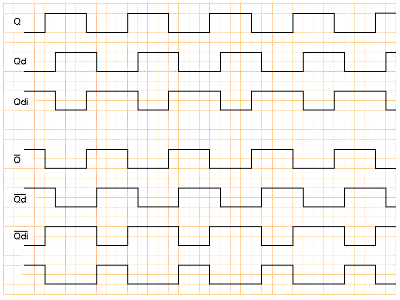

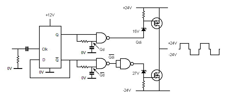

There may be simpler ways to do it but this is one possible solution.
The circuit switches the fets alternately with pulses which do not overlap thus avoiding shorts across the 48V.
They're the last two pulse trains in the second diagram.

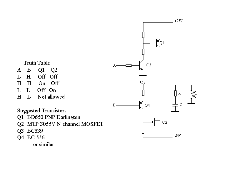

Here is my suggestion.
In order to specify the components, I need to know the inductance and resistance of the coils.
I could not find a cheap P channel MOSFET (at a brief scan) so had to use a Darlington transistor for Q1.
Len
