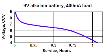

A half-alive 9V alkaline battery can provide up to 400mA to blow up your LEDs without current-limiting resistors.
